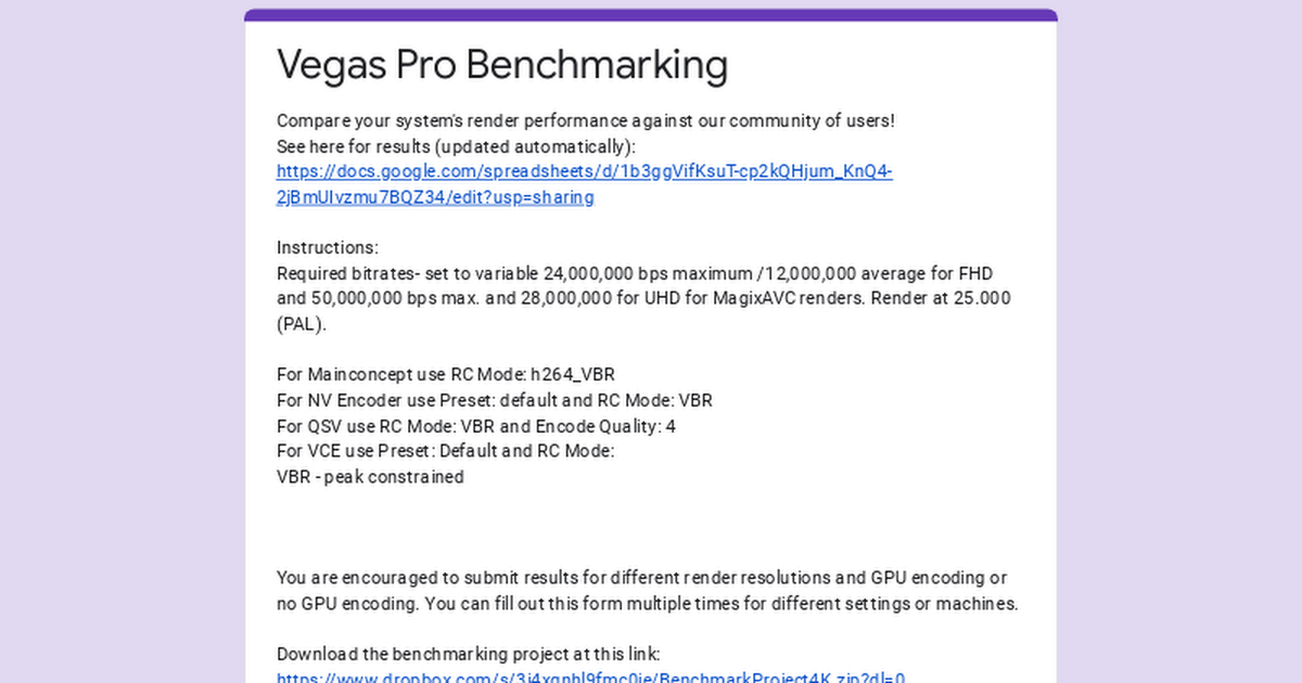

  • If you'd be willing to test your different NVIDIA cards on a standardized benchmark it could provide valuable data. This benchmark project works with VP 16+:
    Vegas Pro Benchmarking
    Compare your system's render performance against our community of users! See here for results (updated automatically):…
    forms.gle
    If you also want to compare Voukoder render times you can put that in the comment field.
