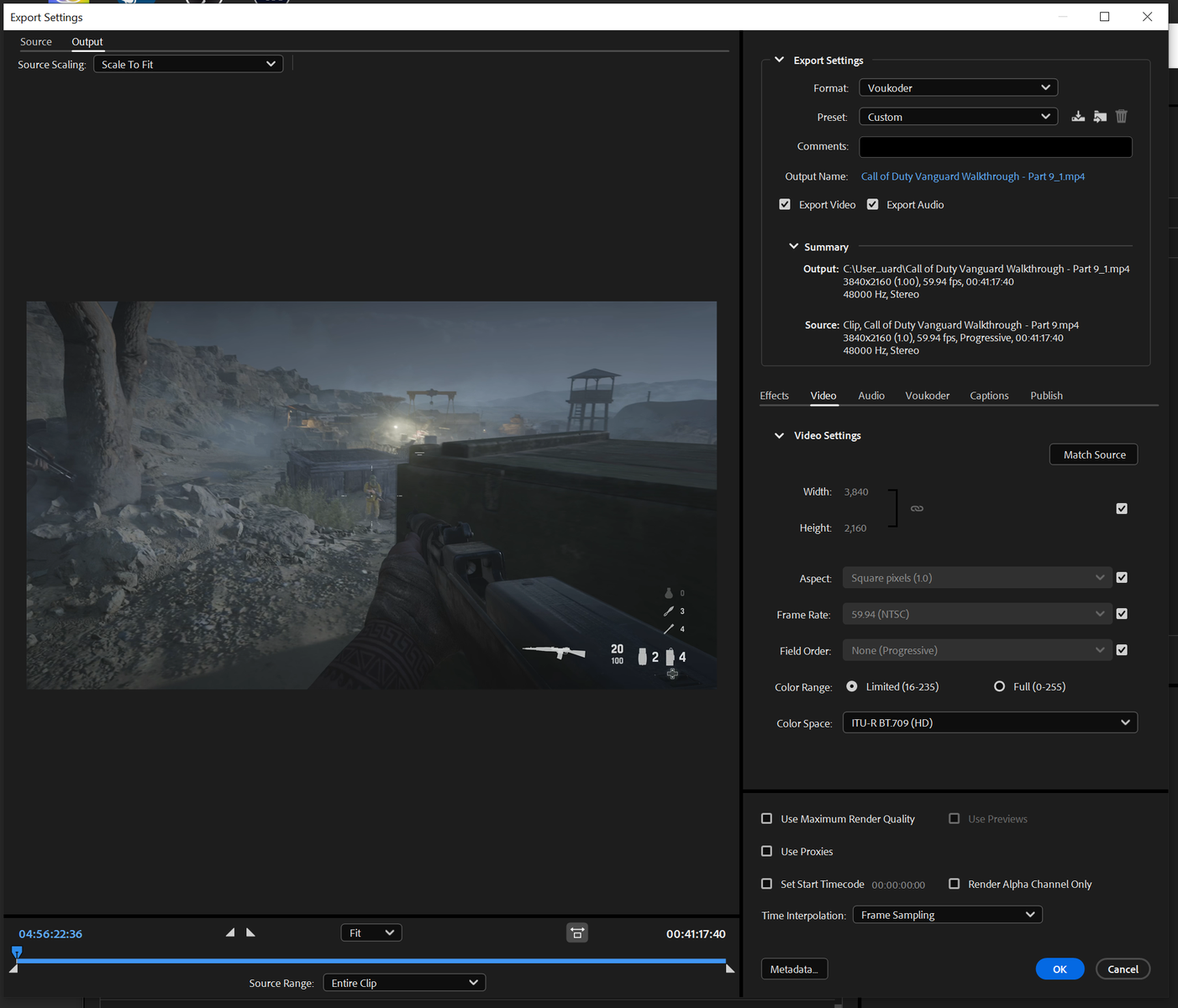

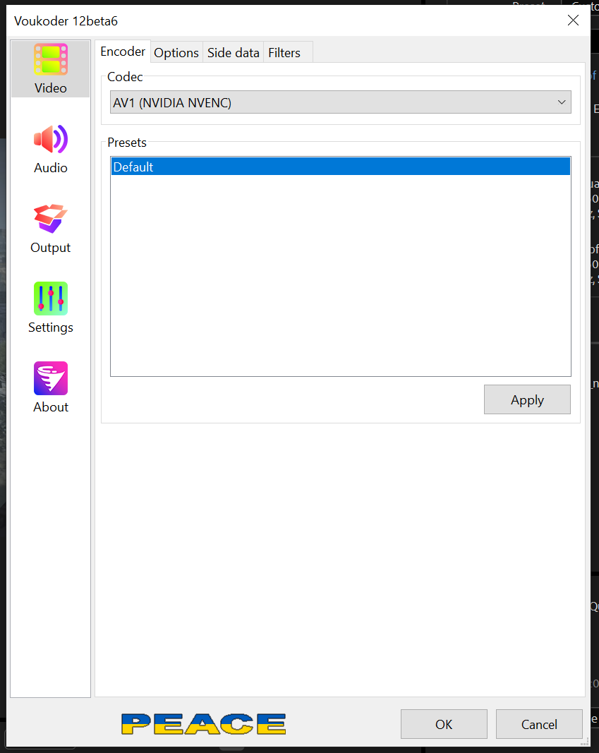

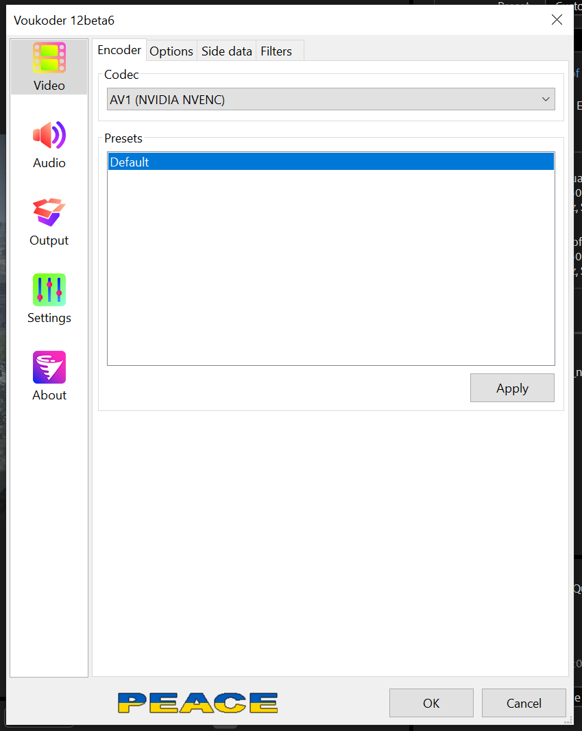

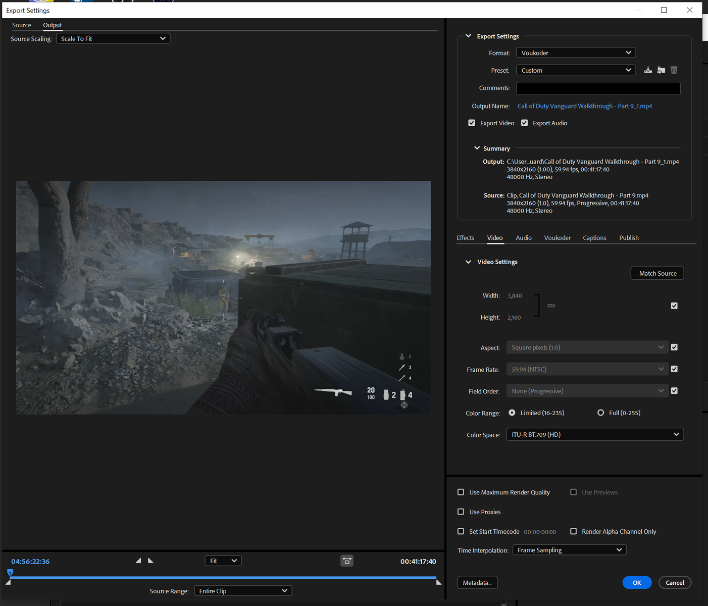

I just tried using the latest Voukoder Beta supporting the NVENC AV1 encoder. I have a RTX 4090 so it should be possible to use it. I used the Adobe Connector to use it in Media Encoder.
My main idea using AV1 is for YouTube. I am doing recordings of Gameplay and they end up in a huge filesize and uploading takes a long due to only 50Mbit upload.

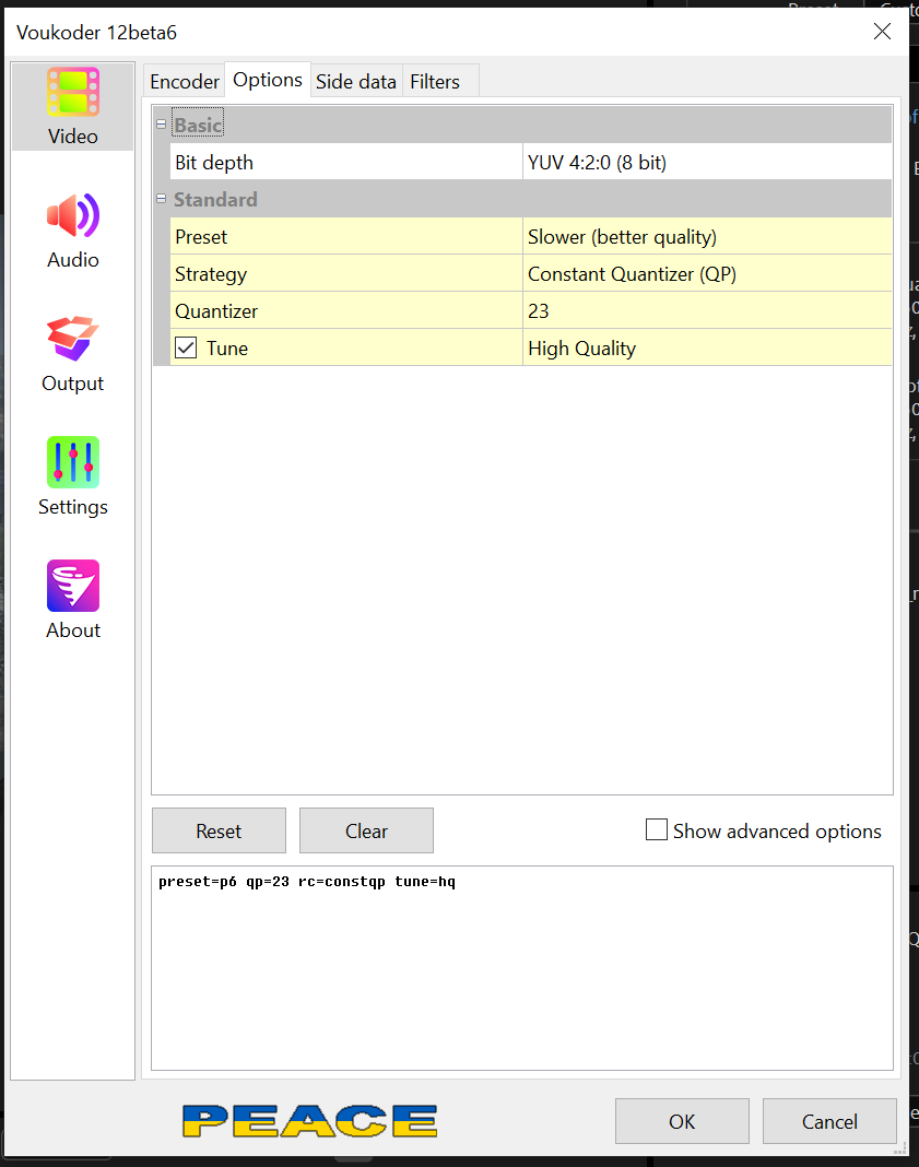

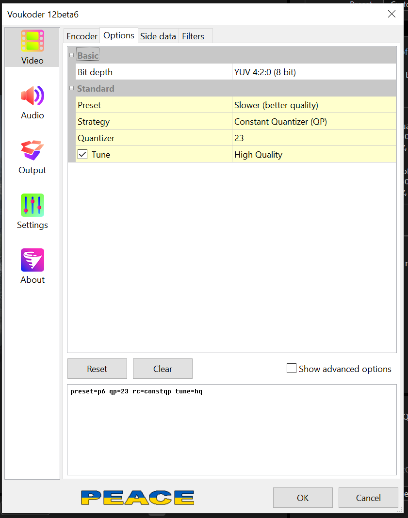

Now in Media Encoder I select Voukoder and and set the Preset to Slowest (Best Quality) and the Quantizer at 23 (default). Everything else is at default.
The resulting quality is fine but the filezise is now 14.3 GB large.
My I misunderstood the purpose of AV1 but I thought its so great it should reduce the size and be better than HEVC or H264 ? Am I doing something wrong ?
