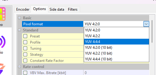

This is what the video portion of the format looks like with ffprobe.
Stream #0:0[0x1](und): Video: h264 (High 4:2:2 Intra) (avc1 / 0x31637661), yuv422p10le(tv, bt709, progressive), 3840x2160 [SAR 1:1 DAR 16:9], 229419 kb/s, 23.98 fps, 23.98 tbr, 24k tbn (default)

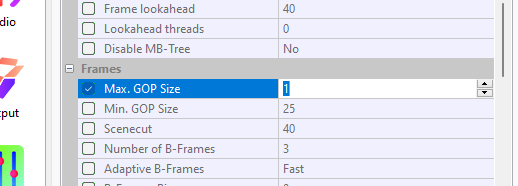

Many of these settings are a bit daunting to me. From my understanding, intra formats are only i-frames?

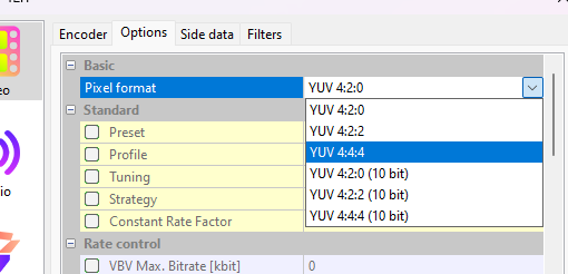

I see the 444 general purpose 10bit prores alternative, but there are quite a few settings being used that I was surprised to see in use like Noise Reduction. But I don't know, maybe ProRes Does that?

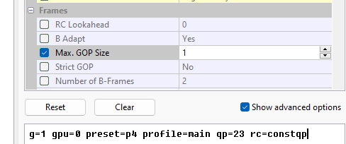

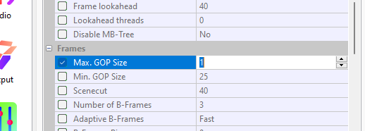

So how do I get Intra frame? Can I just change the I-P ratio to 1.0? Is that forcing only i-frames?

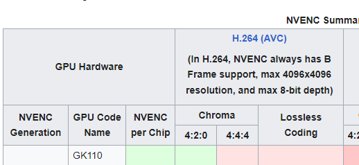

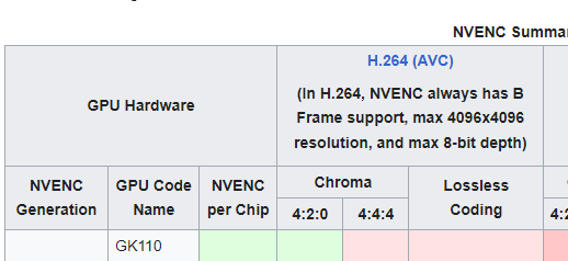

Ideally, I'd use CUDA to render also. It seems to be Quite a bit faster. But it also looks to be much more limited in the options available.
