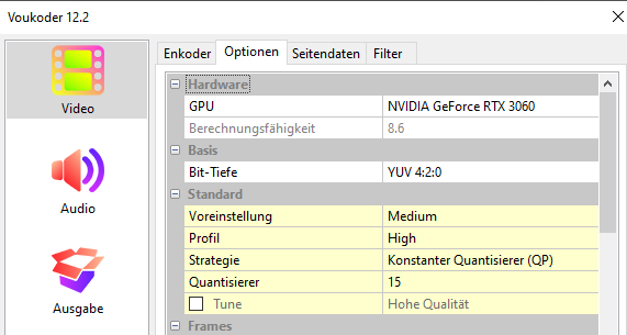

  • Now the newest voukoder version shows my graphics card in the encoders but the same problem occurs as with the older voukoder version where the render display disappears almost immiedately after clicking on "render" before being able to reach a singlular percent.

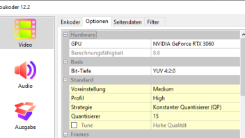

  • Newer NVENC cards (starting with Turing) also can't encode interlaced video, which you have enabled in your first screenshot (the Field Order option). Try progressive video instead.
    Didn't work, sorry. I should've mentioned that not all my projects have interlacing activated and since I've tried rendering multiple projects I should've listed the differences to my original project.

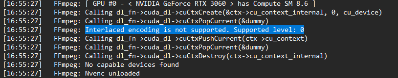

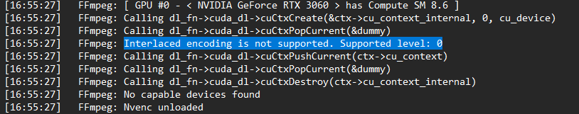

    Also I have messaged the log file but it wasn't permitted by a mod yet.
    [16:55:27] FFmpeg: No capable devices found
    [16:55:27] FFmpeg: Nvenc unloaded
    [16:55:27] Failed opening codec: h264_nvenc
    [16:55:27] Unable to open video encoder: h264_nvenc
    [16:55:27] Closing encoders ...
    [16:55:27] Opening encoder failed! Aborting ...
    [16:55:27] Unable to open encoder.
    (these are the last 7 lines of the log)

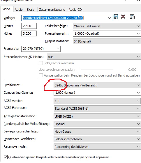

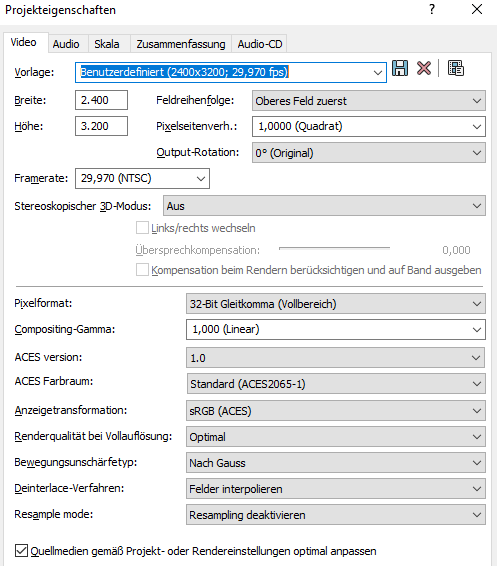

  • There might be more than one problem with your settings. Is this log from before or after you changed to progressive video?
    Is that what you meant with disabling interlacing? Because I tried that yesterday and it actually worked! The whole time the problem was right infront of me I just didn't notice it because I never change the field order since the default is "none (progressive scan)" but for whatever reason this was automatically set to "upper field first" in my recent projects which is why voukoder didn't work. I don't know why vegas did that but the problem is fixed now. Thank you so much to all of you!
