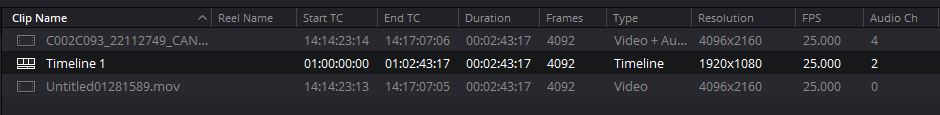

We find some output file timecode offset 1 frame before, but use internal coded render is ok.
So We have make a new project with only 1 clip and render whole clip without grading.
but the problem still happened.
Resolve 18.1.4 , voukoder 13 , Connector 0.10
render setting : inividual clips, voukoder format, source resolution, 422 mov output.
RESULT
Source file : C002C093_2211....MXF START TC 14:14:23:14 END TC 14:17:07:06
render output file : Untitled01281589.mov STARt TC 14:14:23:13 END TC 14:17:07:05
in the log file, time code also is wrong.
[14:14:38] Timebase: 1/25 (25.00 fps)
[14:14:38] Options: _pixelFormat=yuv420p _timecode=14:14:23:13 opencl=1
