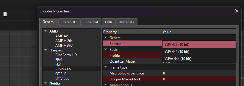

    I've installed the VoukoderPro Beta, and in Davinci Resolve Studio can see this.
    But after click 'Open Scene Desinger' and modify a bit, if click 'save' will show the error.
    And in Resolve, the Scene area cannot select something.
    BR / Aulus

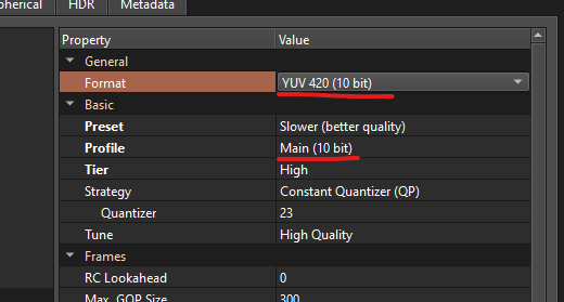

    I did select "YUV 422 10bit" in Resolve 18.5 as input format for VoukoderPro, then in VoukoderPro select Format as "YUV 420 (10bit)" and Profile as "Main 10".
    But final output file vis MediaInfo checking still as "HEVC YUV 420 8bit", not as I wanted of "HEVC YUV 420 10bit".

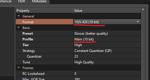

    I reinstalled the latest 0.7.1.9 (Beta Version) and using in Davinci Resolve Studio 18.5.
    I select YUV422(10bit), and in the Scene, double click video line, and select "YUV 420 (10bit)" and Profile as "Main 10", then start rendering.
    But the output file cannot be recognized, the size is also strange, around 6MB only (should be around 200MB I think).
    And when I re-do the rending process, then Davinci suddendly crash-out.

  • Thanks a lot for the quick reply!
    I've installed the 0.7.1.10 version.
    Following screen shot:
    - Right side: shows the parameters I set in Davinci and VoukoderPro.

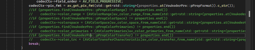

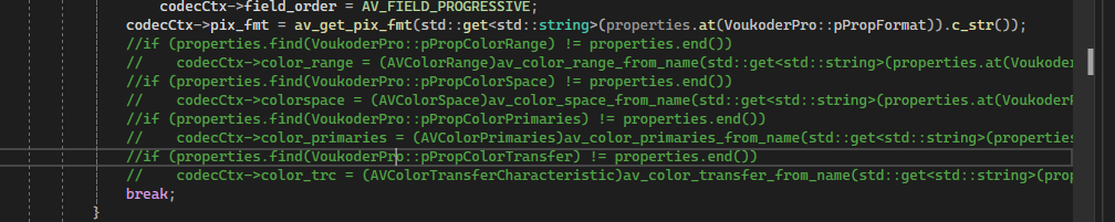

    1. VoukoderPro created mov file, during checking by MediaInfo app, the mov files cannot show 'color range' and so on parameters, any plan to add the showing function to VoukodePro ?
    If I just could remember why I removed these lines from the code ... AFAIK there was an issue with HDR export ...
    Need to check this.

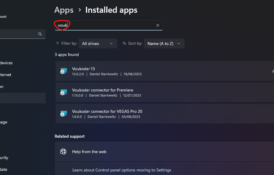

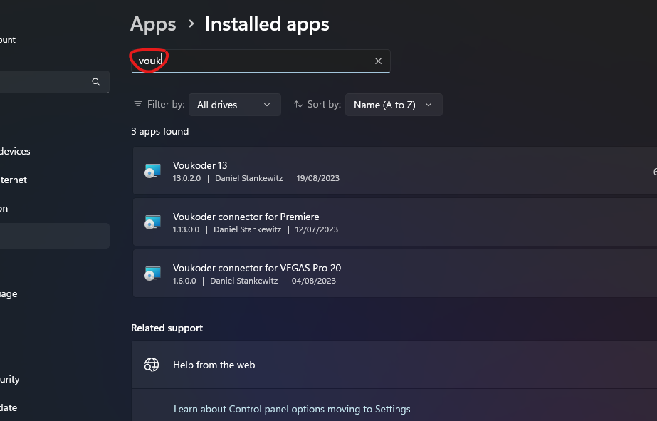

  • I've installed the vkpro 0.7.2.1
    Also installed the traditional vk 13

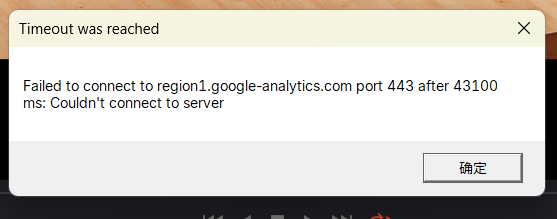

    BTW, after I installed the vkpro (no matter 0.7.2.1 or previous versions), why always pup-up a small window like this ?
