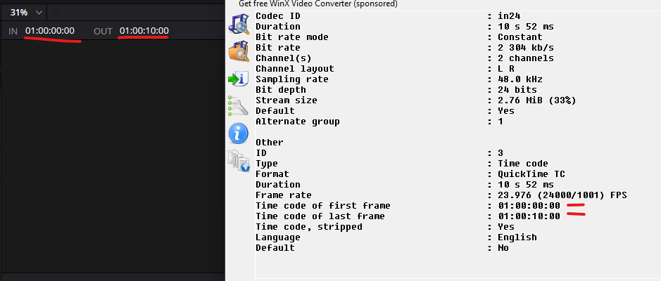

The file after rendering in Da Vinci is 7 frames shorter than the duration of the sequence
  • The file after rendering in Da Vinci is 7 frames shorter than the duration of the sequence.
    For example:
    Time code of last frame : 00:19:58:17 (VoukoderPro 0.7.1.9 Beta Version),
    while correct Time code of last frame (Voukoder 13 05/17/2023 with CONNECTOR 0.12.4) : 00:19:58:24
