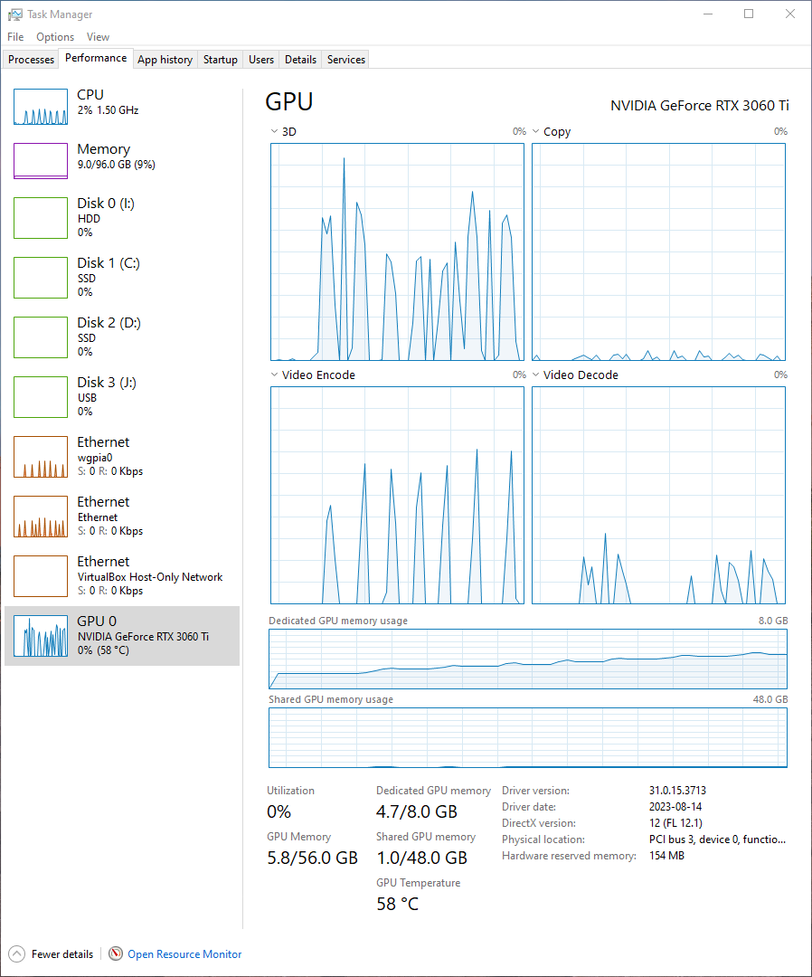

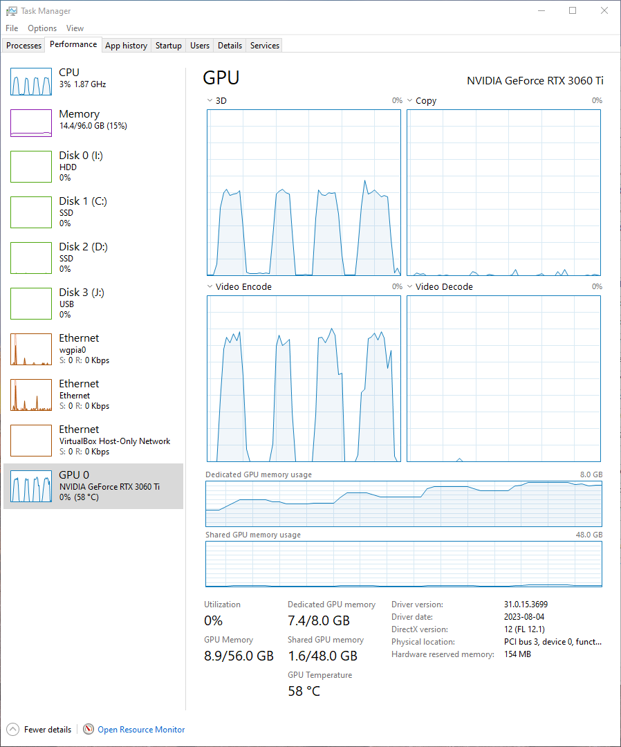

    Screenshot taken partway through the test run:
    Einmal editiert, zuletzt von Joe24 (28. August 2023 um 09:21)
  • No change in version 0.7.2.8. Tried just a single render, and the problem exists there too.

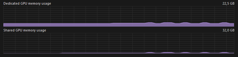

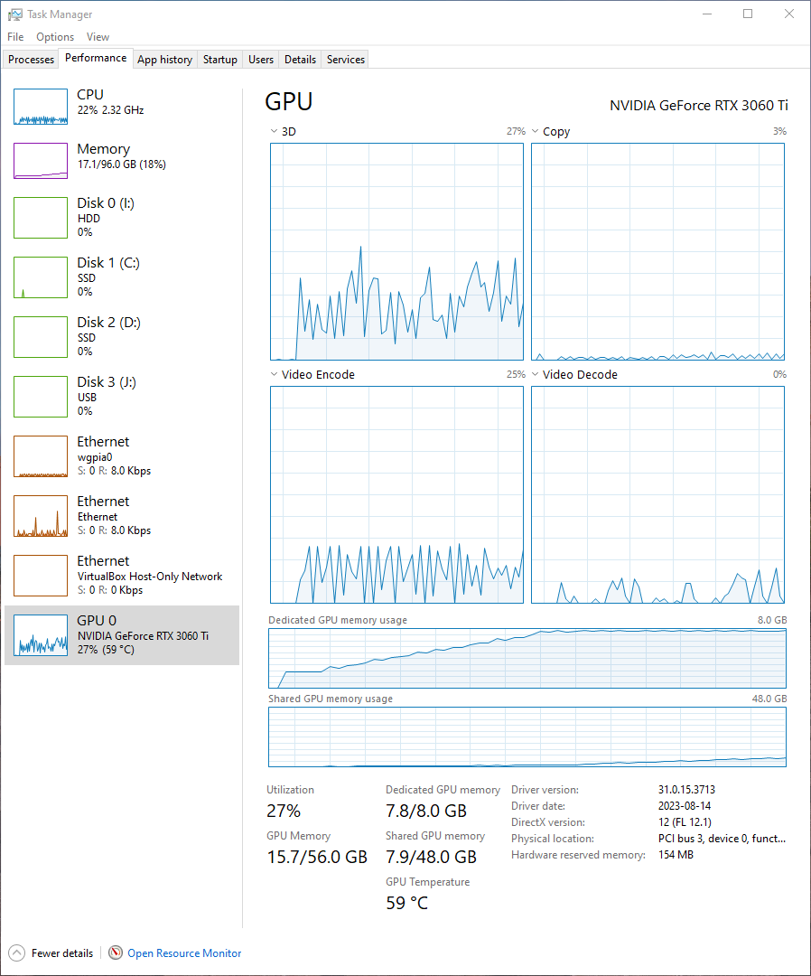

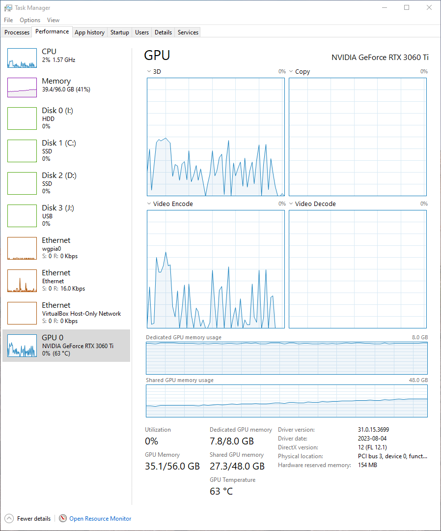

    I tried to see if there was an upper limit to the memory usage. Eventually VoukoderPro does refuse to run, displays error "Unable to start VoukoderPro: Undefined error!" Screenshot below is taken at this point, after starting and stopping the same render many times. As you can see, the total video memory usage has grown to over 35 GB.
    The last few lines of the log file at the time of the crash are:
    And here's an example scene that causes the issue:
    temp v0.1.scene.zip
    11 Mal editiert, zuletzt von Joe24 (30. August 2023 um 02:03)

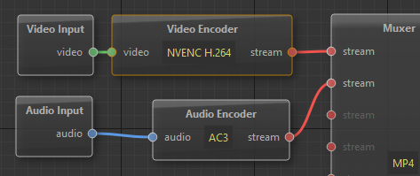

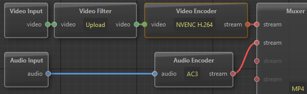

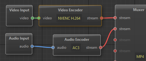

    What I'm seeing so far is that when the following chain is used, there is no memory leak: Video input -> NVENC encoder (either h.264 or HEVC).
    works.scene.zip

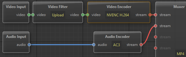

    However, when the following chain is used, the memory leak exists: Video input -> CUDA upload -> NVENC encoder (either h.264 or HEVC).
    doesn't work.scene.zip

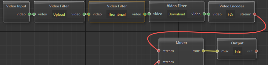

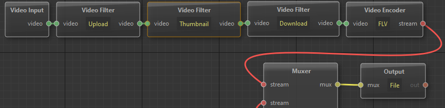

    The only other possibly-related unusual behavior I've noticed so far is with the CUDA Thumbnail filter. Maybe not a leak, but something is getting left behind in GPU memory, then cleared at the start of each render:
    Load Vegas, 1.3 GB GPU memory.
    During 1st render with Thumbnail filter: 1.8 GB
    After 1st render: 1.8 GB
    Immediately after starting 2nd render: briefly drops back to 1.3 GB
    During 2nd render: 1.8 GB
    After 2nd render: 1.8 GB
    thumbnail filter.scene.zip
    9 Mal editiert, zuletzt von Joe24 (31. August 2023 um 08:50)

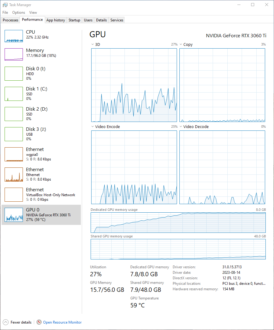

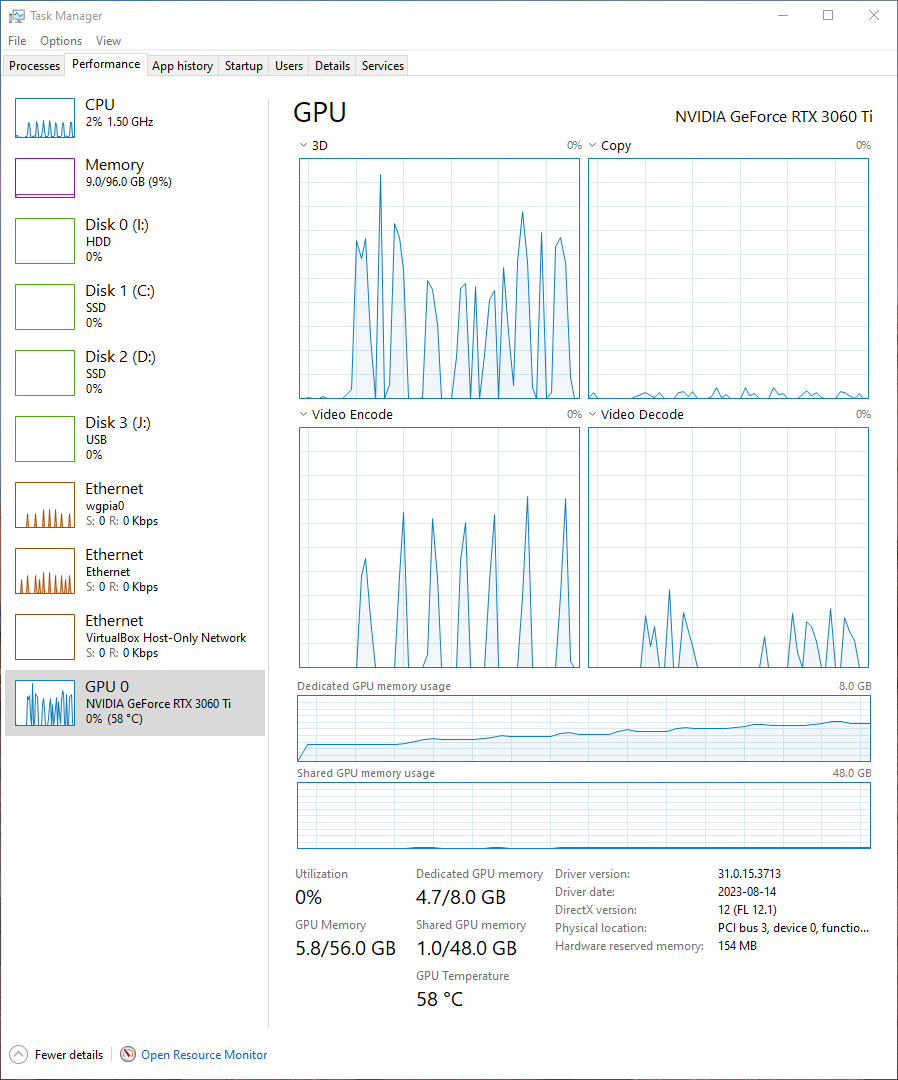

  • Using "doesn't work.scene" from above (post #11). Single encode, single card, single instance of Vegas 20, stock drivers, VoPro 0.7.2.9.
    7 runs using normal graph speed in Task Manager:
    30 runs using slow graph speed in Task Manager:
    2 Mal editiert, zuletzt von Joe24 (1. September 2023 um 10:25)
