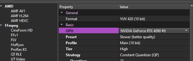

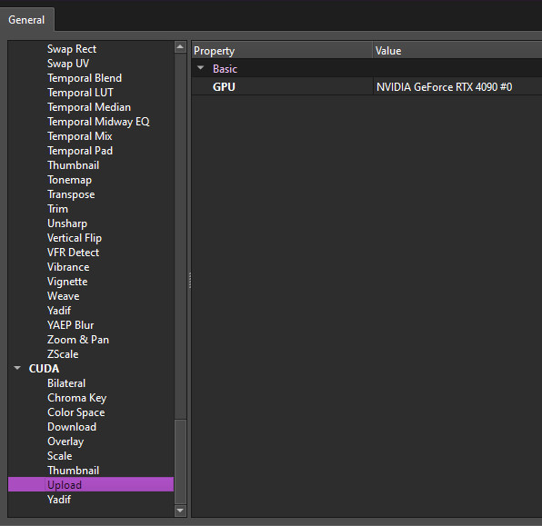

    Testing on a 2-GPU system, VoPro version 0.7.2.8, Vegas 20 build 411. GPU was assigned by setting the target GPU in the CUDA Upload filter.

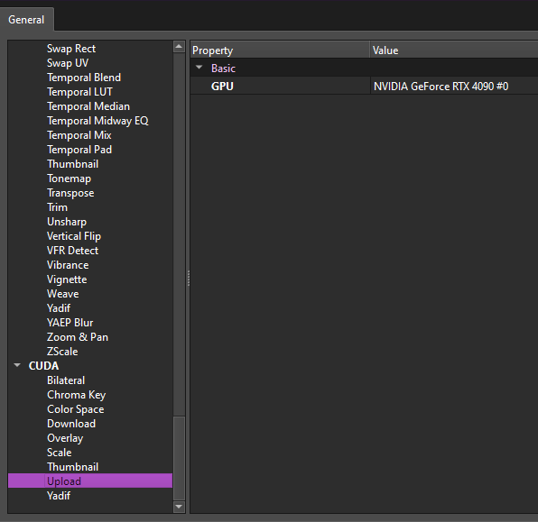

  • Seems like the duplicate assertions of the target GPU are causing problems. Directly encoding (Video Input -> Encoder) on GPU0/1/2 works. But when using (Video Input -> CUDA Upload -> Encoder), FFmpeg scrams.
    This appears to be caused by the duplicate GPU assertion commands issued to FFmpeg (both Upload and Encoder nodes have options to choose a GPU in Scene Designer). These duplicate commands are not being accepted by FFmpeg. For instance, commanding an Upload to GPU2, then commanding an NVENC encode also on GPU2. FFmpeg acknowledges the first assertion, but rejects the second.
    As mentioned in the previous post, I don't believe FFmpeg allows you to use the "-gpu " assignment more than once in a single instance. Even if it's to the same GPU.
    This only seems to affect GPUs other than GPU0. When GPU0 is used, I don't see any GPU assertion entries at all in the log file.

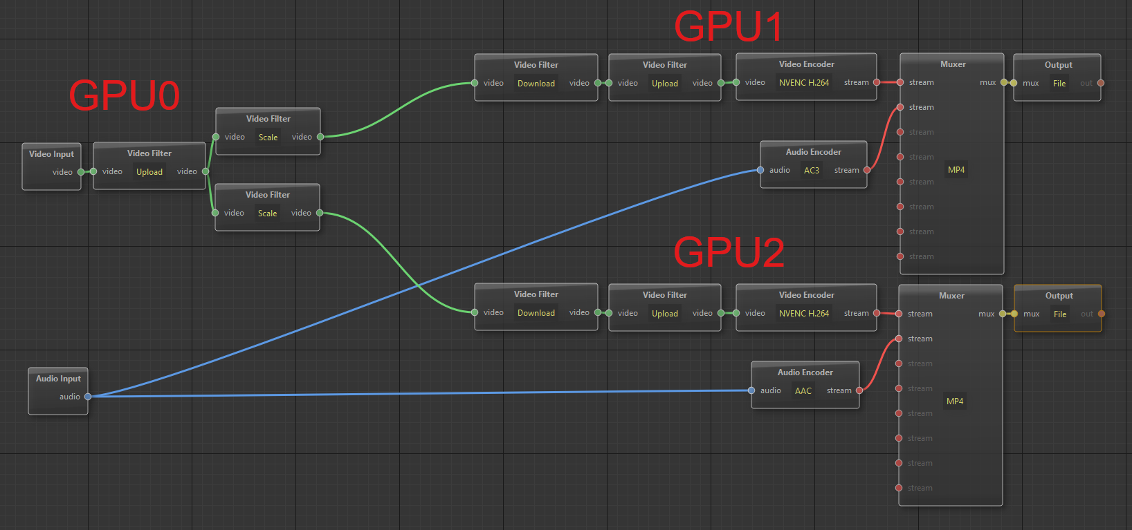

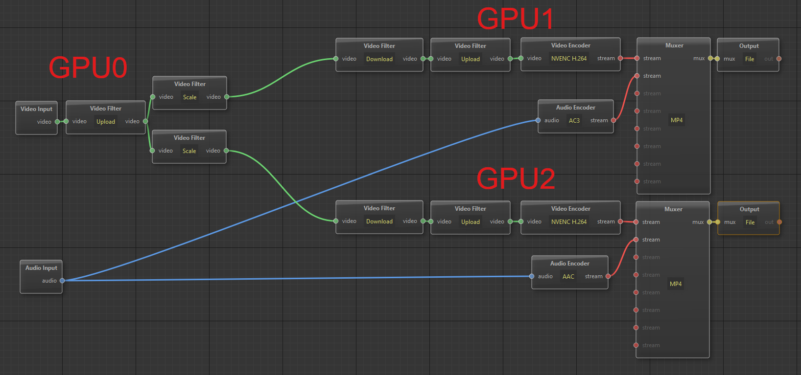

    It is in fact possible to use multiple GPUs from a single FFmpeg command line. There doesn't seem to be a lot of information out there on this topic. However, the following example uses GPU0 to perform resolution-scaling, then GPU1 and GPU2 to encode different formats (1080p, 720p).
    In FFmpeg command line, assigning each NVENC encoder "-gpu 1" or "-gpu 2" is completely pointless, as the encoder always uses whatever GPU was targeted by the previous hwupload_cuda command, regardless of NVENC GPU preference in the command line. If you (nonsensically) specify separate GPUs for Upload and Encode, the Upload GPU setting overrides the Encode GPU setting, and both actions take place on the Upload GPU. So adding/removing the NVENC "-gpu" options makes no difference in function.
    Using 3 GPUs is hilariously inefficient for such a small job, but the following command is a working example of FFmpeg running a complex operation using 3 GPUs at once. Using uncompressed AVI file input, which seems the most similar to what VoPro is doing (no hardware decoding):
    ffmpeg -y -probesize 42M -analyzeduration 10 -i "d:\temp\input.avi" -filter_complex:a "[0:a]asplit [asplit1][asplit2]" -filter_complex:v "[0:v]hwupload_cuda=0, split [split1][split2], [split1]scale_cuda=1920:1080:interp_algo=4:format=yuv420p:force_original_aspect_ratio=1, hwdownload, hwupload_cuda=1 [split1scaled],[split2]scale_cuda=1280:720:interp_algo=4:format=yuv420p:force_original_aspect_ratio=1, hwdownload, hwupload_cuda=2 [split2scaled]" -map "[asplit1]" -c:a ac3 -b:a 96k -map "[split1scaled]" -c:v h264_nvenc -gpu 1 -2pass 0 -b:v 2500k -maxrate 5000k -bufsize 5000k -bluray-compat 1 -coder 1 -cq 0 -g 48 -level 4 -preset:v p7 -profile:v high -rc:v vbr -rc-lookahead 20 -tune:v hq "output_1080v4.9.mp4" -map "[asplit2]" -c:a aac -profile:a aac_main -b:a 96k -map "[split2scaled]" -c:v h264_nvenc -gpu 2 -2pass 0 -b_ref_mode:v middle -preset:v p7 -profile:v 2 -qp 30 -rc 0 -rc-lookahead 20 -tune:v hq "output_720v2.1.mp4"
    Corresponding VoPro Scene would be something like this: 3-GPU.scene.zip This cannot yet be tested due to the current bug (as of version 0.7.4).
