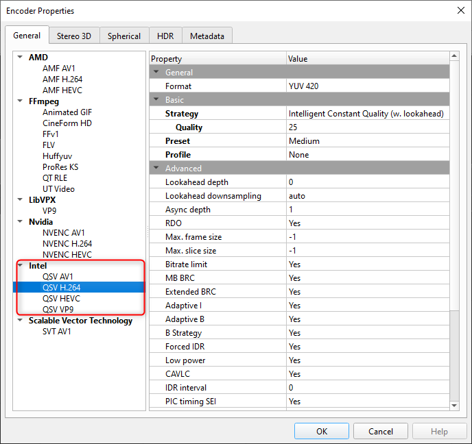

Is it possible to add the H264 codec without Intel Quick Sync? I think currently the H264 codec in Voukoder Pro only works with a Gen 6 or higher Intel processor.
This option will allow users with older processors to use the H264 codec.

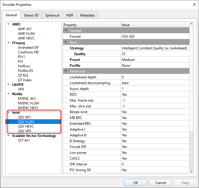

If you want to hardware-encode to h.264 format on an old computer, just buy a cheap video card and use the card's built-in NVENC or AMF hardware encoder (shown in your list above). Doesn't matter how old your CPU is for that.
Or you can use the x264 software encoder, which will be very slow but should still work on older CPUs. Voukoder classic includes the x264 encoder. VoukoderPro so far does not.
