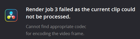

  • I'm trying to render a video with the simple "H.264" preset. Whenever I try to begin the render, I get the following error:
    "Render Job 1 failed as the current clip could not be processed. Cannot find appropriate codec for encoding the video frame."
