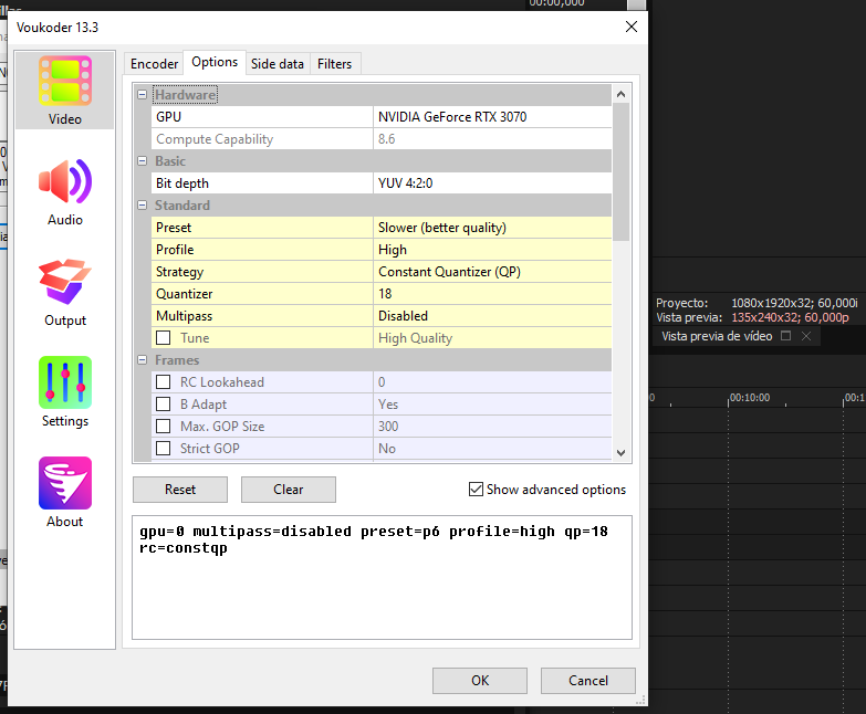

  • Hello, as I read, this encoder takes the configuration that your project has in Vegas Pro, it turns out that doing it with a 1920x1080 project did not have any problems, it was absolutely incredible. The problem comes when I also wanted to render a video in "tiktok" or 1080x1920 format, as soon as I hit render it goes black and ends instantly, meaning it doesn't work. I also tried adding a filter and setting the resolution in both ratio and pixels but it gave me the same result, any solution for this? Below I leave the configuration I used and the logs

  • [20:03:45] Interlaced:      Top first
    You are trying to render an interlaced video with the 3070. NVIDIA does not support this anymore with turing based (and later) GPUs.

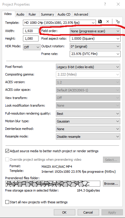

  • Interlacing has nothing to do with resolution or vertical/horizontal mode. You must have accidentally enabled interlace when you changed resolution.
    You can disable this in your Vegas Project Settings (File -> Properties). For the Field Order option, select "None (progressive scan)."
