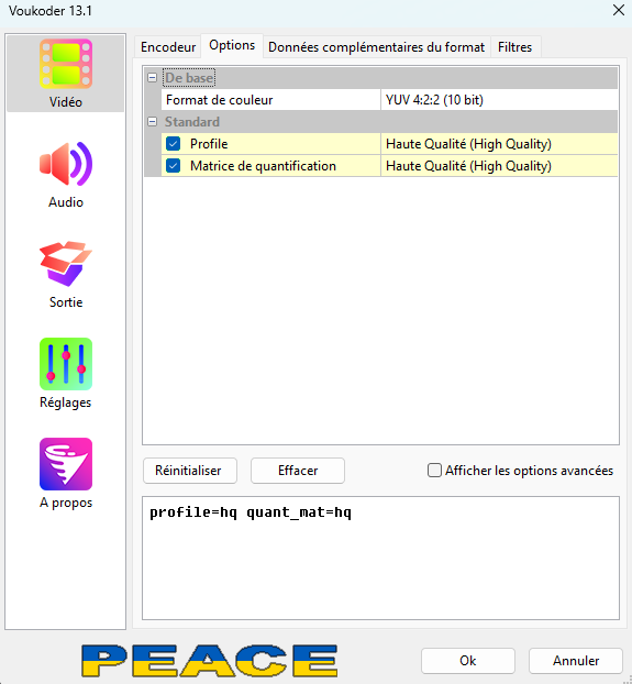

So, I was wondering what is the best way to export AppleProRes422HQ out ouf Davinci Resolve on Windows to get as close as possible as what an export out of a Mac machine would give. I think I get it pretty close but there are still some parts that I don't really know if I'm doing it correctly:

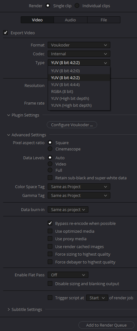

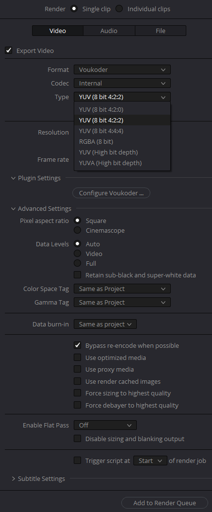

Here are my settings for DVR and Voukoder:
If I'm correct, AppleProRes422HQ have a 10bit color depth. I see that I can set that in voukoder with no issues but in DVR, I'm limited to YUV 8bit 422? Do you habe any ideas how to get 10bit out this thing? Is this bad if it is set in 8bit? Curious to have a hint on this

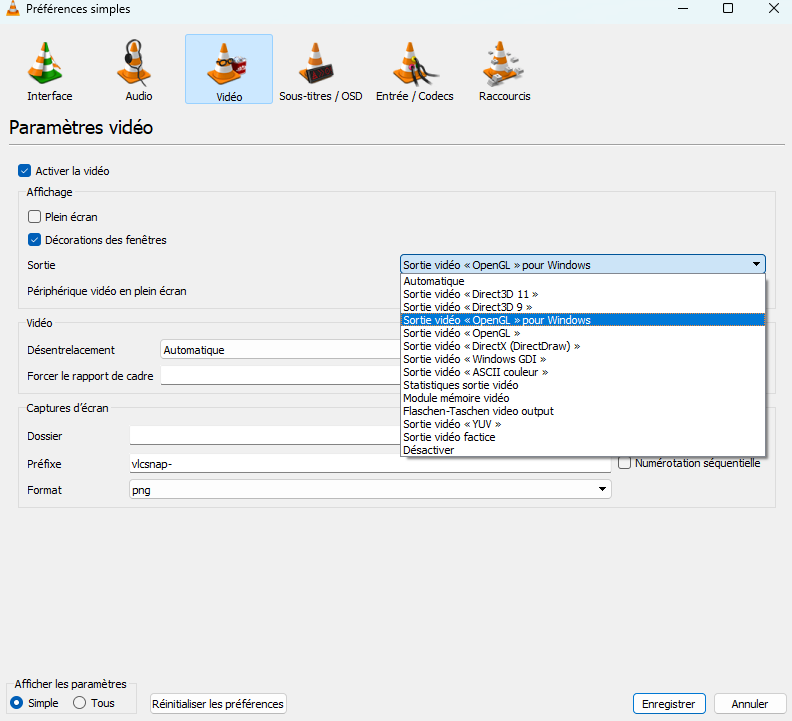

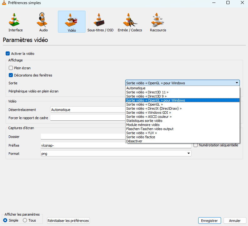

After doing some researche, I found a fix to this. I had to go into the VLC settings and set the video output setting from "automatic" to "OpenGl for windows". After changing this settings, playback was fine and the gamma issues was fixes (the image I see match what I saw in DVR before exporting)
Here's the setting I'm talking about:

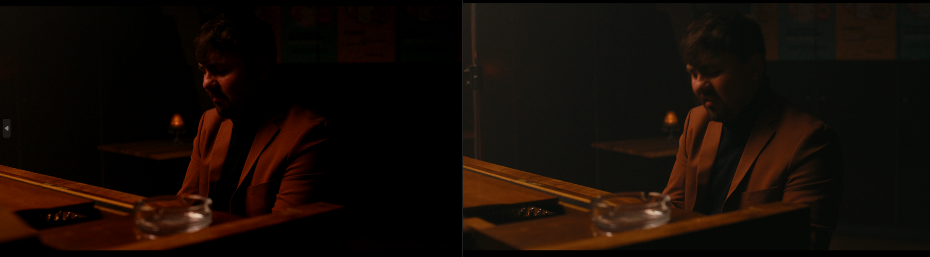

And here you can see the gamma difference between playing the clip in "automatic" (left) and "OpenGl for Windows" (right)
Do you have any explanations about this VLC issue? Is-it maybe related to the data-level setting in DVR ? It would explain the gamma shift but not the sloppy playback i guess.
