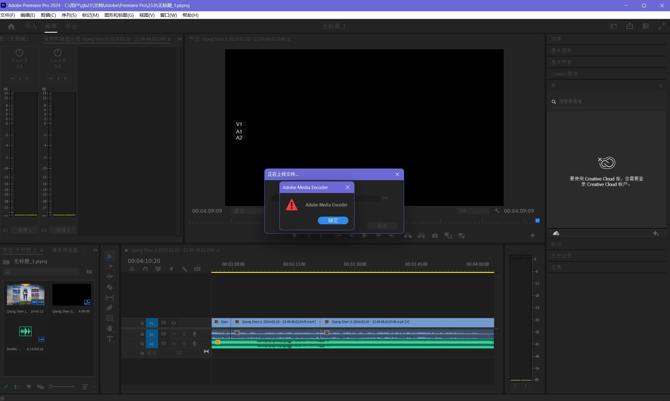

I cannot output the video, I had tried many times.
I have searched "Impossible to convert between the formats supported by the filter". It seems that there is a error on hardware acceleration?

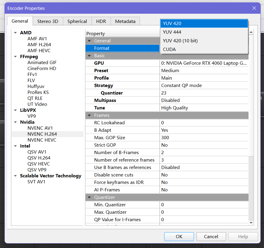

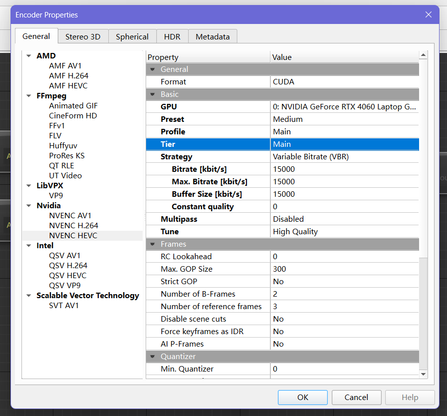

Seems to me like this is a filter issue. You have selected CUDA as pixel format for the encoder, but you are not uploading it to the GPU. So you have to either:
- Use the CUDA Upload filter
- Or select a normal, non-CUDA pixel format
Yes, what happens if you set it to YUV 420? Can you post the new logfile please?
