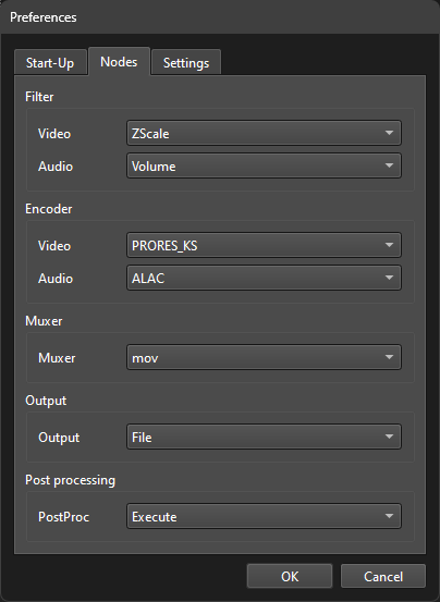

... and I am probably blind or stupid or both. But where to find any real documentation of its settings? Particularly, Tools->Preferences-Nodes and there is a "Filter" option for Video and Audio with a litany of filters available. I understand these are internal to Voukoder Pro and are somehow applied during rendering. How to set their settings, if they have any changeable settings at all? and - particularly - how to use no such filter at all? If my post is pointless because everything is explained elsewhere in plain view - then sorry.

thanks and yes You are right, but unfortunately i am not as smart as to ingest it. particularly under the link above there's no reference to NVENC encoding which i use very much. On the other hand for example i cannot find a setting in Voukoder Pro to change number of reference frames in NVENC H264. And it does not seem to be a limitation of hardware (gtx 970) since files generated by nvenc through Voukoder Pro have 4 ref frames per GOP by default while generated directly from Vegas Pro have 1 ref frame per GOP (and GOP fixed to 30 frames while through Voukoder it can be changed to 50 frames for example).
ok, could i then have an answer how to use no filter at all in Nodes->Filter ?

now i understand how it works. those on the screenshot are only defaults when the filter node is called and created. no filter node means no filter used.
