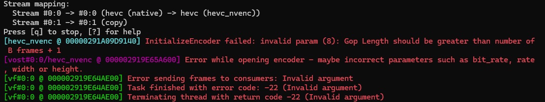

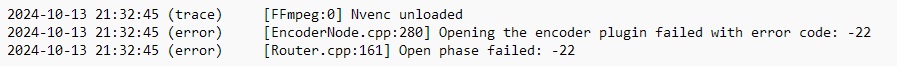

  • GOP = 1 is an invalid value in nvenc_hevc and fails on voukoder pro 1.3.0.0.
    This setting results in nvenc error 22:
    In nvenc_hevc gop=1 is an invalid setting (group of frames of "one" is no group at all.)
    in FFmpeg ("-c:v" "hevc_nvenc" "-g:v" "1") delivers same error:
    To enable All-Intra you should use GOP=0 (disable group of frames)
    Valid settings for GOP (-g:v) are:
    0 All-Intra
    1 Invalid
    2 Should incl bframe setting (-bf:v) to overwrite default "3", otherwise nvenc_hevc fails. Valid values for "-bf:v" are 0 or 1 (IPP,IBB)
    3 Should incl bframe setting (-bf:v) to overwrite default "3", otherwise nvenc_hevc fails. Valid values for "-bf:v" are 0,1,2 (IPP,IBP,IBB)
    4+ Valid with defaults
    Simplest fix to this issue:

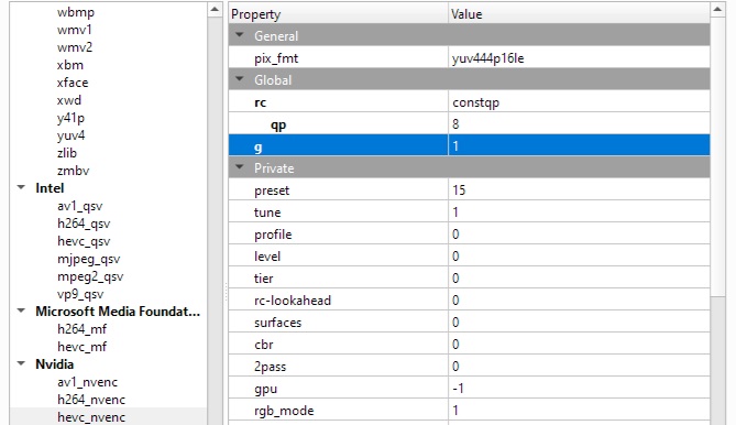

    -change min value for GOP "-g:v" from 1 to 0
    -include the bframe "-bf:v" parameter to overwrite the default max number of b-frames (default is 3)
    This still allows invalid combinations but at least it enables All-Intra and low GOP settings

    You could open %LOCALAPPDATA%\VoukoderPro\scenes.json and edit the params section of the encoder/video node with a text editor:
    "params": {
    "g": 0,
    "bf": 0
    But i can't guarantee these settings survive a "save" action with the Designer app.
    Edit: I have added the params to all h264 and hevc encoders.
