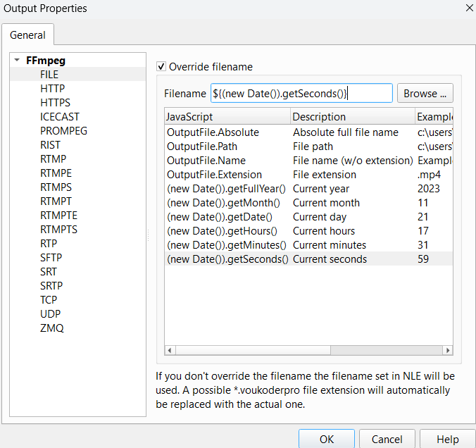

    I've tried to use most of the displayed JavaScript Date functions to construct an output filename but, whenever one is used, Voukoder is unable to start. Is this a bug or a training issue (!)? ${OutputFile.Absolute} etc work fine, it's just these embedded Date() calls.

    Seems like a permissioning problem:
    This was not working:
    • c:\${(new Date()).getSeconds()}.mp4
    This was working:
    • d:\${(new Date()).getSeconds()}.mp4
    • C:\Users\Daniel\OneDrive - Voukoder\Desktop\${(new Date()).getSeconds()}.mp4
    Just make sure it is a valid absolute file name.

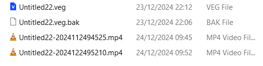

    I'd like to create a mask like <original path><original filename (excl extension)-YYYYMMDDHHMMSS<extension>. I'm almost there with the following, and have worked out that I can add a 1 to getMonth() so that function return 1-12 rather than 0 to 11 etc. and I'm sure I'll be able to prepend a 0 to those values that are less than 10. But that is making it quite difficult to do this in you single row field, so I'm resorting to pasting this part of the JS into the field once tested elsewhere:
    ${OutputFile.Path}\${OutputFile.Name}-${(new Date()).getFullYear()}${((new Date()).getMonth() +1)}${(new Date()).getDate()}${(new Date()).getHours()}${(new Date()).getMinutes()}${(new Date()).getSeconds()}.mp4
    produces:
    The field has a max. length of 32767 and it has a real JavaScript engine behind so those inputs can be quite complex. But it will get difficult to read and edit in a single line. I might change this to a better editor in a next version.
