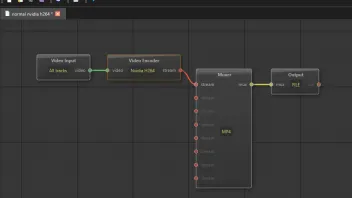

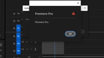

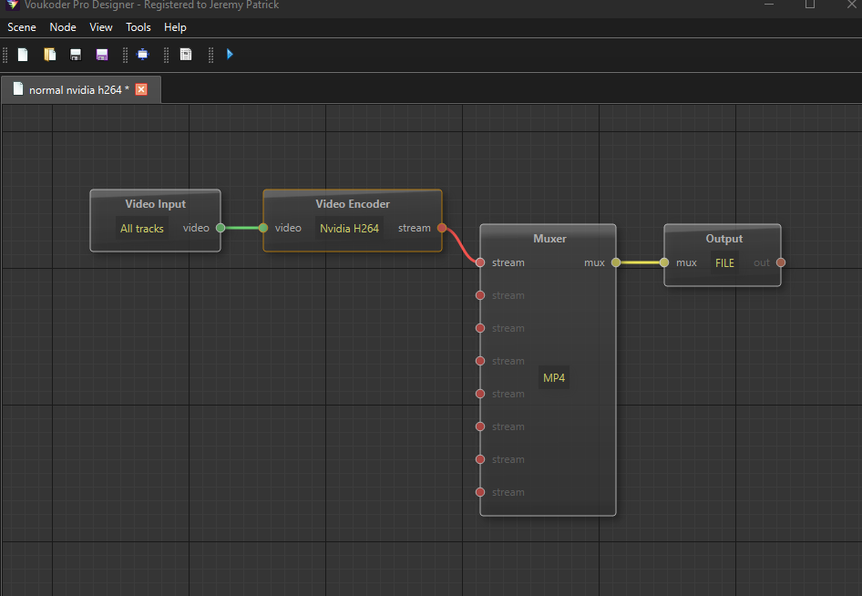

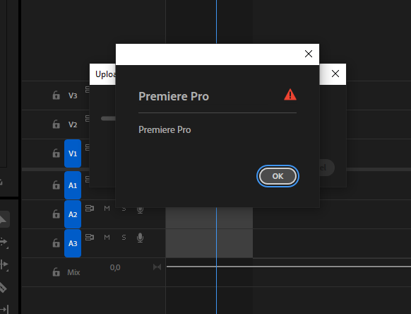

I am unable to export any video other than using those 2 encoders and would just give error messages. I have a good feeling that the main issue of this is because my laptop has 2 gpus. 1 from the amd 5950 and the rtx 3060. but that's just speculation. I did change the GPU numbers on the setting file but it didn't fix it.
unable to export video with any codec other than amd h264 and amd HEVC using premiere pro

You attached to old Voukoder logfile to your post. Can you perform a scene test (The play button ine the designer tool bar), and paste the output here?

Looks like you're trying to export with the format cuda. This is not necessary if you just want to encode with the GPU. Just select i.e. yuv420p as format.
If you want to intentionally use cuda it'd requires you to upload frames from the PC memory to the GPU device first (using the upload filter), then apply a chain of NVIDIA filters, and then process it with the encoder (This still has to be documented).

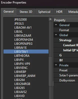

AV1 is not supported on your GPU. It requires an RTX 40xx.
using the old version I was able to use the av1 (svt codec) how do I replicate that using the voukoder pro? I tried every one of them and it failed.
