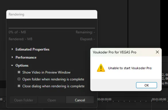

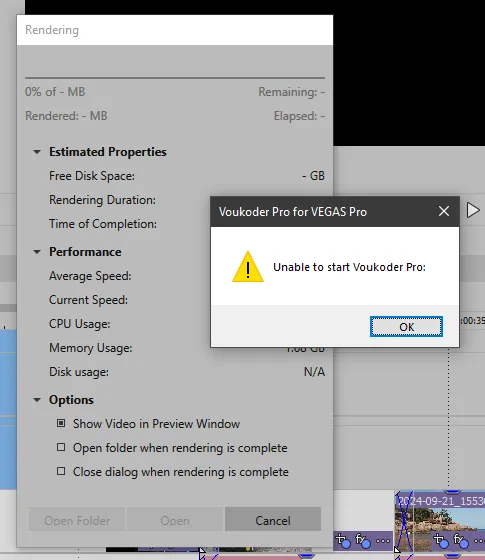

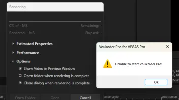

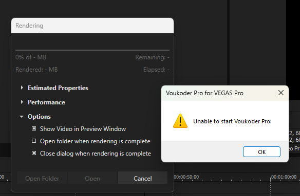

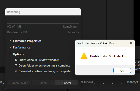

"Unable to Start Voukoder Pro:"
28. Februar 2025 um 10:31 Hat das Thema freigeschaltet. -
This can happen due to a video format error. Meaning your video settings in your NLE may be incompatible with the FFmpeg encoder you're trying to use. Classic example: trying to encode interlaced video using NVENC.

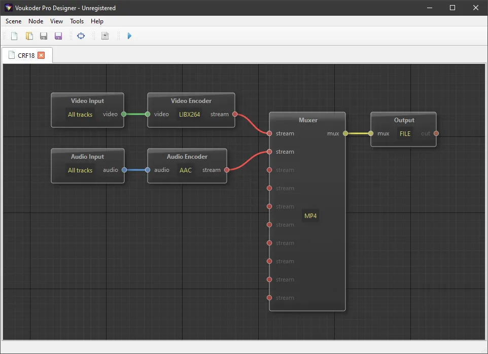

FFmpeg is working fine. Otherwise the designer app wouldn't work properly.
Please copy & paste the log file here:
%LOCALAPPDATA%\VoukoderPro\

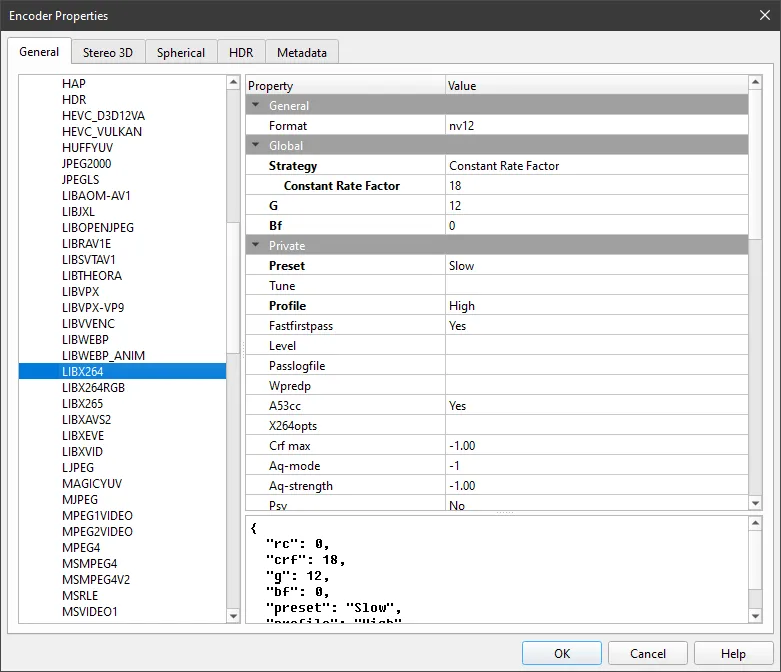

Checked log and fixed the issue. Thanks.

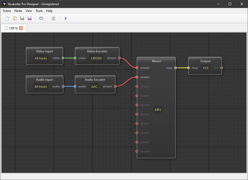

P.S The issue was caused by option "profile: high" that I added. Not sure why it does not like the option:
Code2025-03-26 19:23:19 (info) [EncoderNode.cpp:345] Opening video encoder plugin 'libx264' with params '{"rc":0,"crf":18,"g":12,"bf":0,"preset":"Slow","profile":"High"}' 2025-03-26 19:23:19 (trace) [FFmpeg:0] Undefined constant or missing '(' in 'High' 2025-03-26 19:23:19 (trace) [FFmpeg:0] Unable to parse option value "High" 2025-03-26 19:23:19 (trace) [FFmpeg:0] Error setting option profile to value High. 2025-03-26 19:23:19 (error) [EncoderNode.cpp:354] Opening the encoder plugin failed with error code: -22
It should be all in lower case.
I tried the lowercased and the outcome is exactly the same.

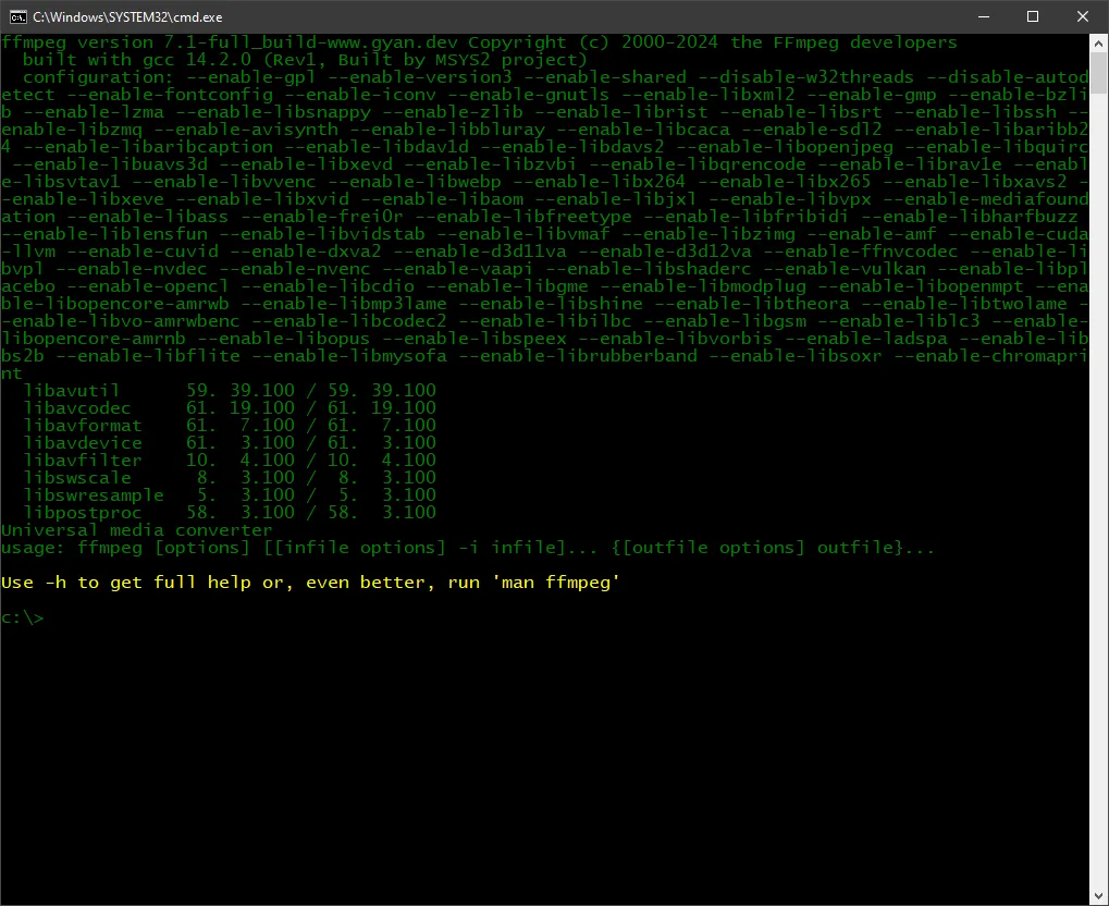

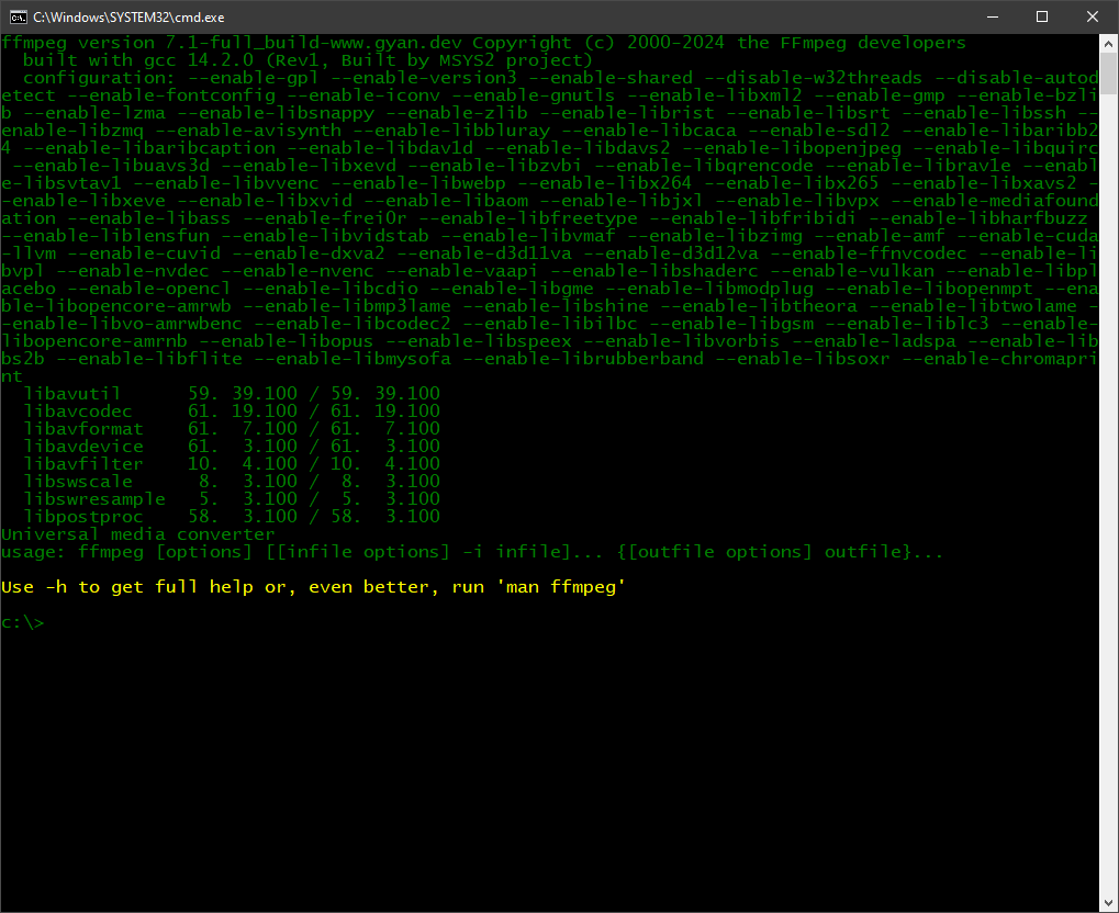

Are you using the latest version of FFmpeg?
Some older versions had issues with the "profile" option. I had to update my FFmpeg to fix that issue.

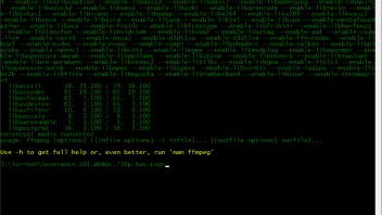

Thanks, will try to update to the most recent release version (7.1.1)
Confirming that after upgrading ffmpeg from version 7.1 release to version 7.1.1 release the option `"profile": "high"` is not causing issues any longer.
Thanks.
