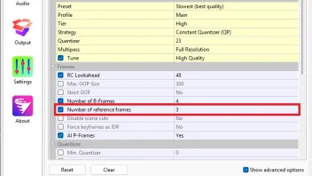

    Where in the new encoder do I set the "Number of reference frames" option?

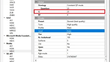

    What is the G option in the new encoder?
    I have a 25 fps video and I set that option to 25. Is that good or not?

    "G" is referring to the FFmpeg "g" option, which means "Keyframe interval". So if you set it to "25" for a 25fps video you'll have a full keyframe every second. Sounds good to me.
