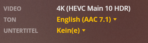

You can encode 10 Bit but I don't think that NVEnc can encode HDR conform.
Oh nvm. you can encode HDR conform. I found a 4K Video file which I encoded a few months ago with NVEnc.
And how do you do that?
Edit: It seems they patch the stream afterwards. So it is correct that NVENC does not support it. People just modify the files afterwards.
I encoded it with StaxRip which uses NVEnc by rigaya with this parameters I think:
--vbrhq 10000 --codec h265 --preset quality --profile main10 --tier high --output-depth 10 --weightp --max-bitrate 10000 --aq --aq-temporal --cuda-schedule spin --videoformat ntsc --colormatrix bt2020nc --colorprim bt2020 --transfer smpte2084 --cabac
In the new NVEnc version you can also set this parameter:
It should be also possible to use ffmpegs filter for that
