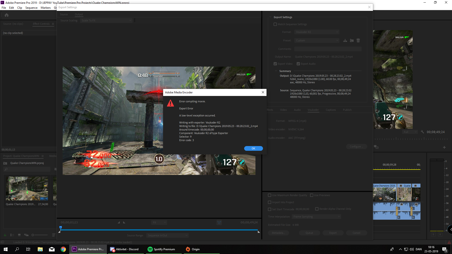

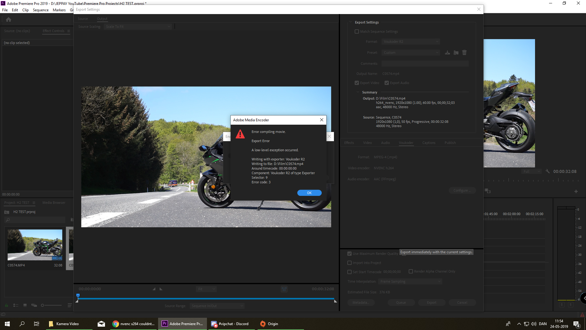

I normally use NVENC x264 and it works like a charm. But now since ive had to change graphics card for my main card to be repaired, i either get the error that nvenc x264 couldnt open or Premiere pro crashes when i use any of the other codecs.

But still i have the same two errors. So you are saying there is a fix made, but not released. Can i do something in the meantime? -

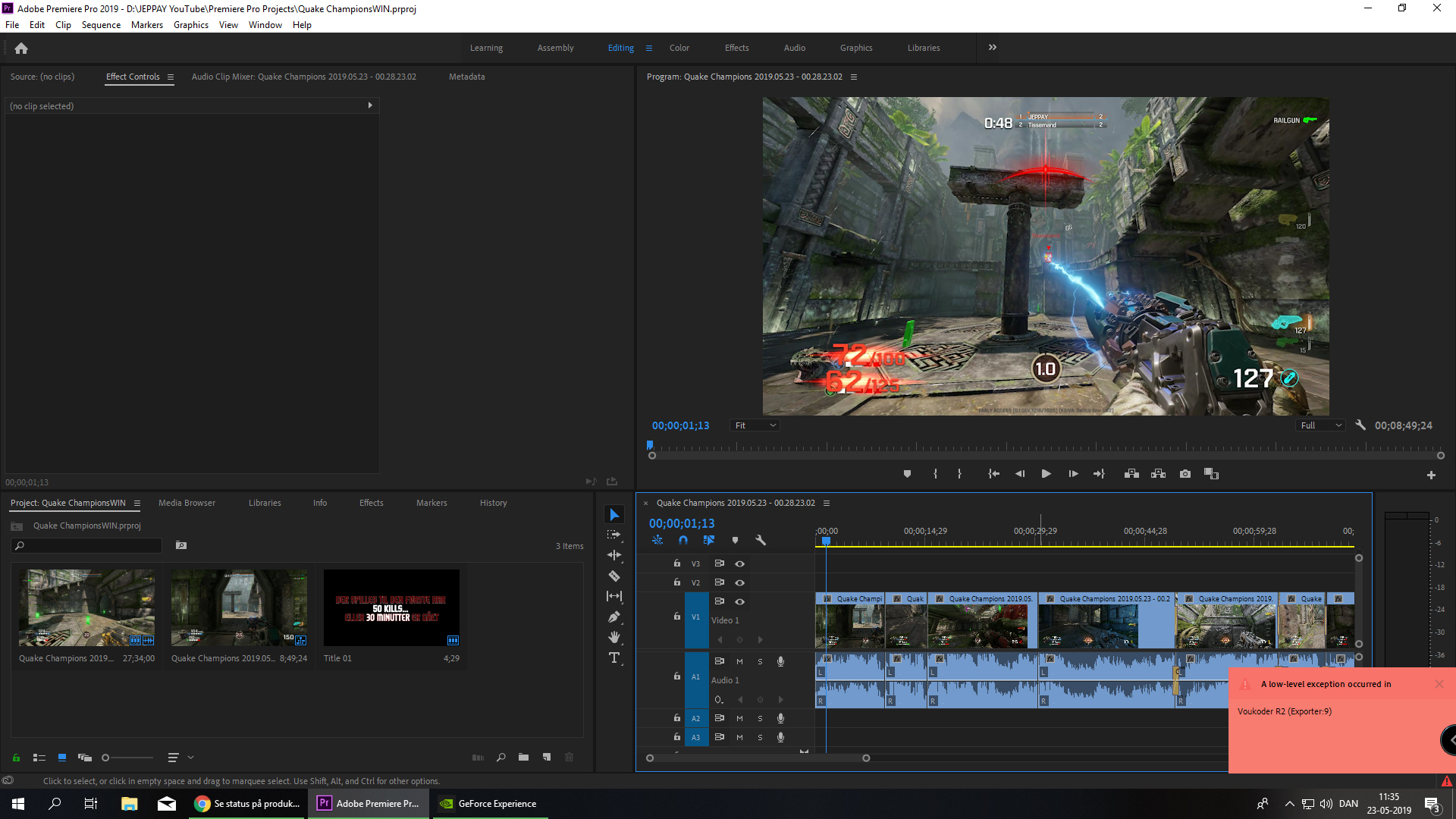

Its actually worse now
- now it shows this error after i cancel export. But it hangs in the system 5-10 seks after asking for EXPORT.
