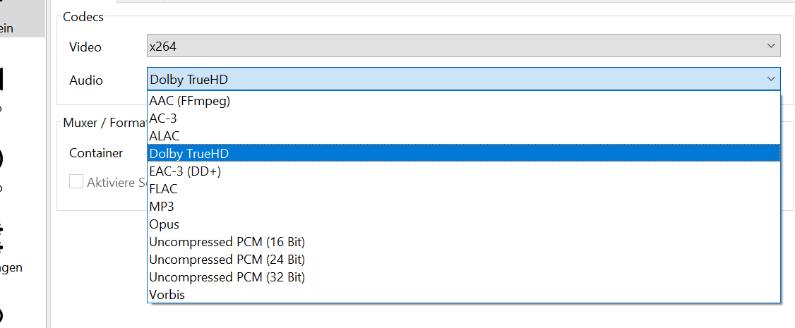

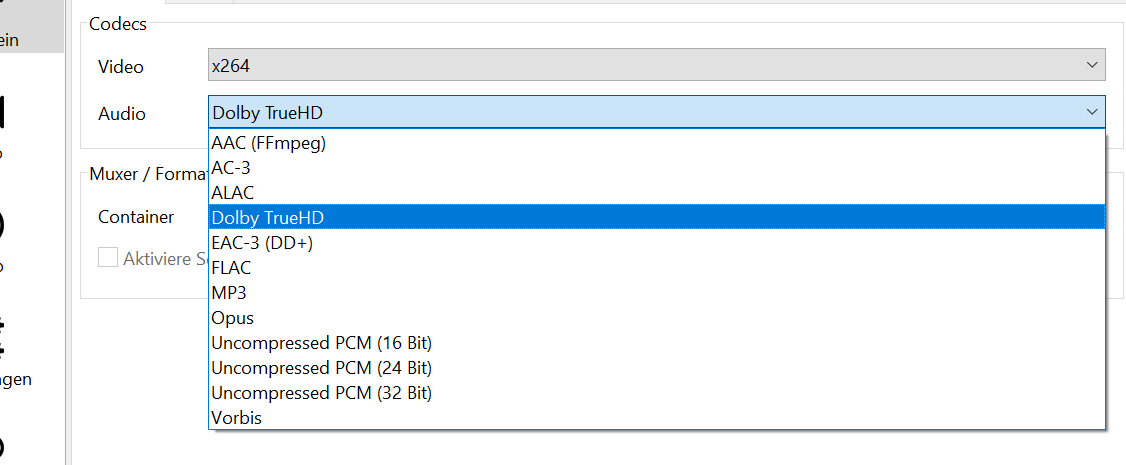

Yes, shouldn't be complicated. Feel free to proceed.
Looks good so far. I am also testing Dolby TrueHD

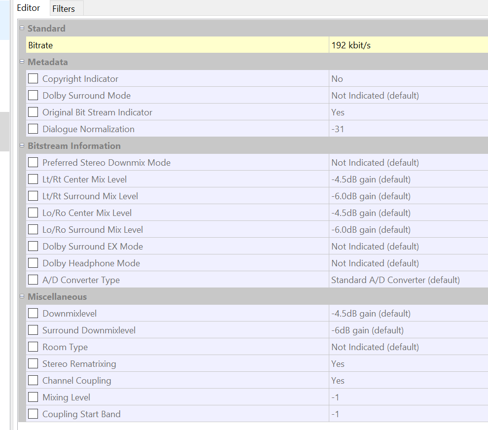

I have also added some more Dolby options. Testing functionality now.
