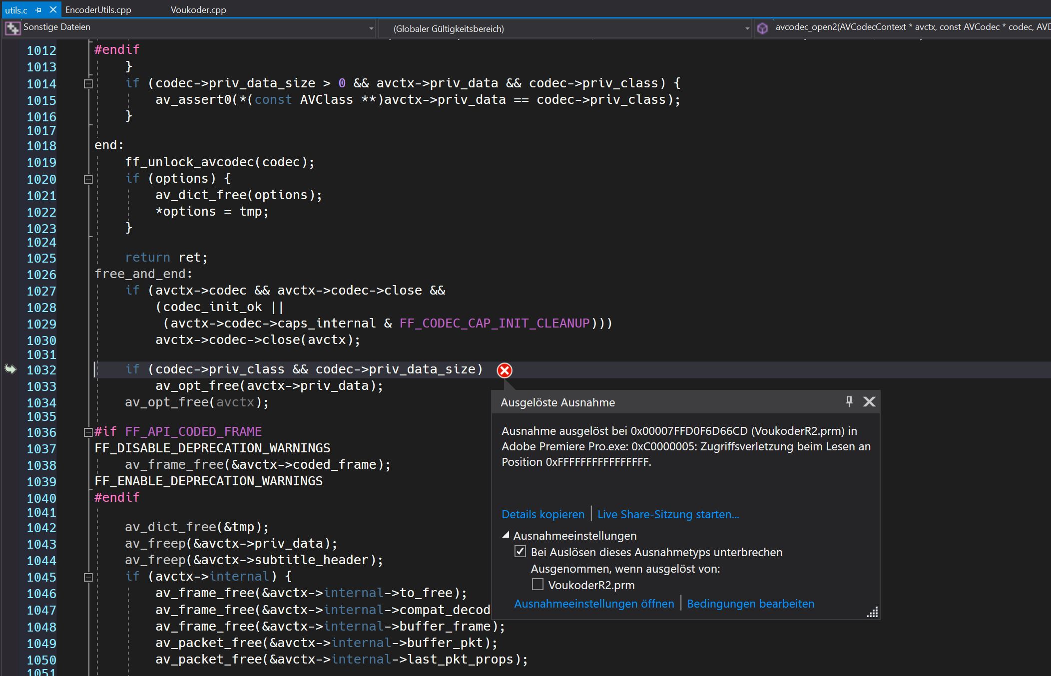

  • When building everything in debug mode Premiere doesn't freeze and I have also tested an export with SVT-AV1 and it worked. The video file looks good so far :) But the question is why it does freeze in release mode?
    I had also a problem with libx264 in debug mode. I got this error every time when compiling ffmpeg with --enable-libx264:
    Has anyone an idea to solve that error?
  • It's really strange, sometimes when running premiere it doesn't freeze when opening the export window and I can export a video with svt-av1. But i can't say whats the exact thing that causes the freeze, expect compiling in release mode.
    But I have also noticed that opening the export window in premiere when compiled in debug mode, premiere is not responding for 1-3 seconds, but then it gets its act together again.
    I think it could be something with the C/c++ optimizations when compiling, because in debug mode it works every time on my side, except the little not responding time.

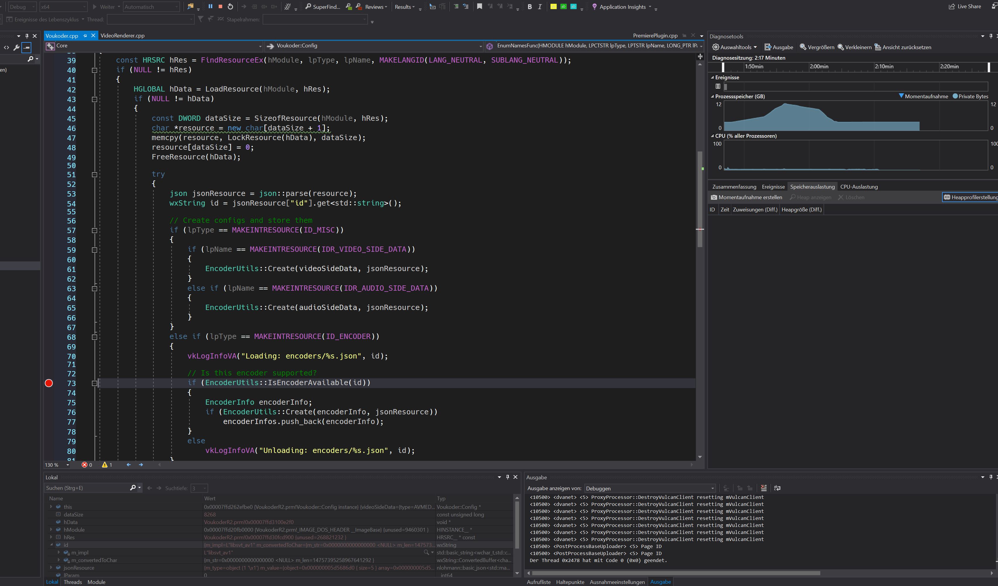

  • When opening the export window and svt-av1 is initialized to check if the codec is available, the ram usage goes up to 12 GB from 4GB. In visual studio you can also see that there are a lot of threads which are starting when svt-av1 is loaded. This scenario appears only when svt-av1 is loaded. You can see it in the screenshot below
    If I skip the check with this code:
    if (id == "libsvt_av1") {
                            EncoderInfo encoderInfo;
                            if (EncoderUtils::Create(encoderInfo, jsonResource))
                                encoderInfos.push_back(encoderInfo);
                            return TRUE;
    everything works normal.

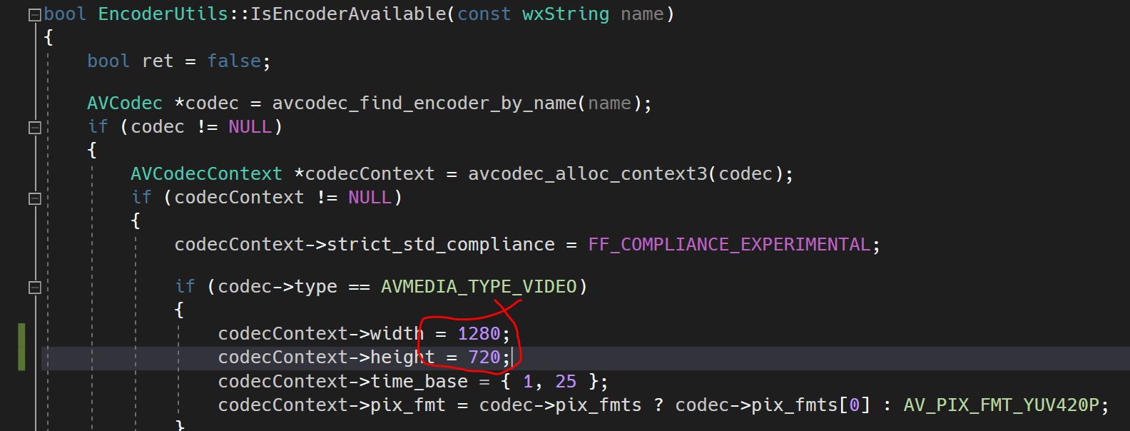

  • I think I have maybe found a fix and an speed improvement in general :)
    Setting the resolution to HD instead of FHD speeds up loading times of every video codec. For SVT-AV1 it means RAM usage only goes at 9 GB and the loading time from 9 seconds to 2,5 seconds in debug mode.
    I will test later in release mode. I have attachted a screenshot with the lines in the source code (EncoderUtils.cpp).
  • The smallest resolution I could set without the exception was 1280x720. I have also tested SVT-Av1 in release mode now with this lower resolution. Premiere freeze hasn't stopped in general, but I could open export window more often without freezing with this lower resolution (something around 3/10 times it works instead of 1/10). For now we should wait a while as you said, before implementing it finally. I will test SVT-HEVC and SVT-VP9 in the next days if they have the same issue in release mode and write my results down here :)

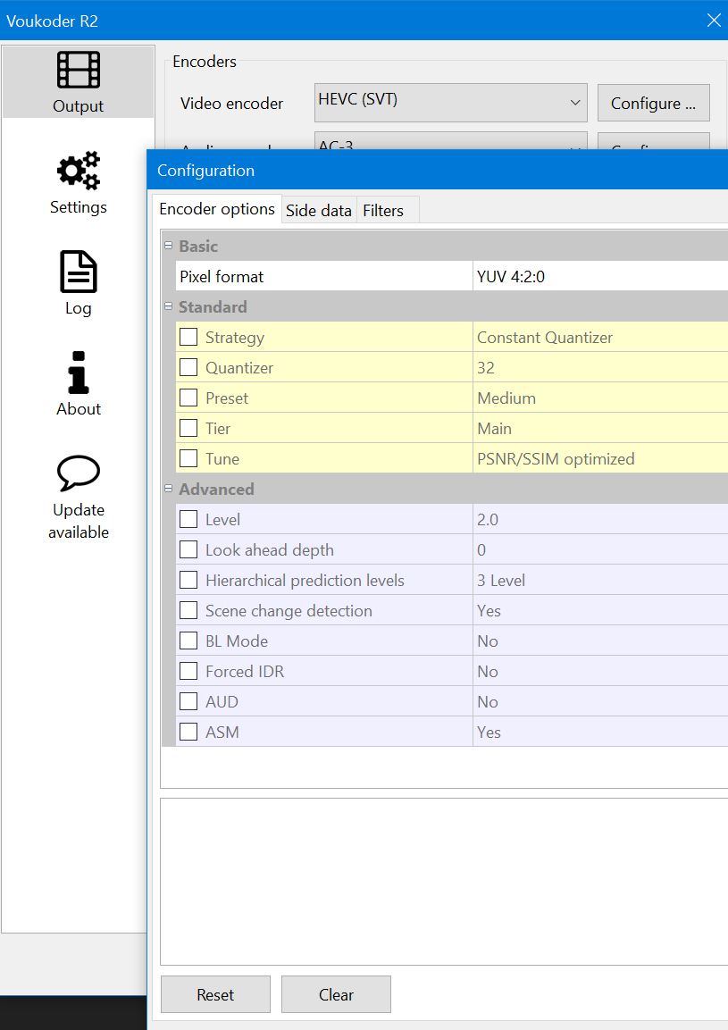

  • SVT-HEVC is working fine without any freeze or memory leak. Exporting a video file works as well :)
    Performance is also impressive compared to default hevc (1080p default encoder settings):
    Exported 5278 frames in 46 seconds. (avg. 113 fps)
    CPU usage was all the time at 100% :)
