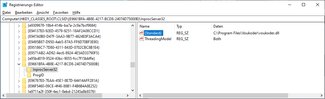

I also cannot open the settings.
This is the button (Grayed out)
https://i.imgur.com/Y67D3OQ.png
EDIT: I could fix this issue, with installing vegas pro 17 testversion > installing voukoder there > succesfully opening the dialoug > now i can open the presets in vegas pro 15 again
