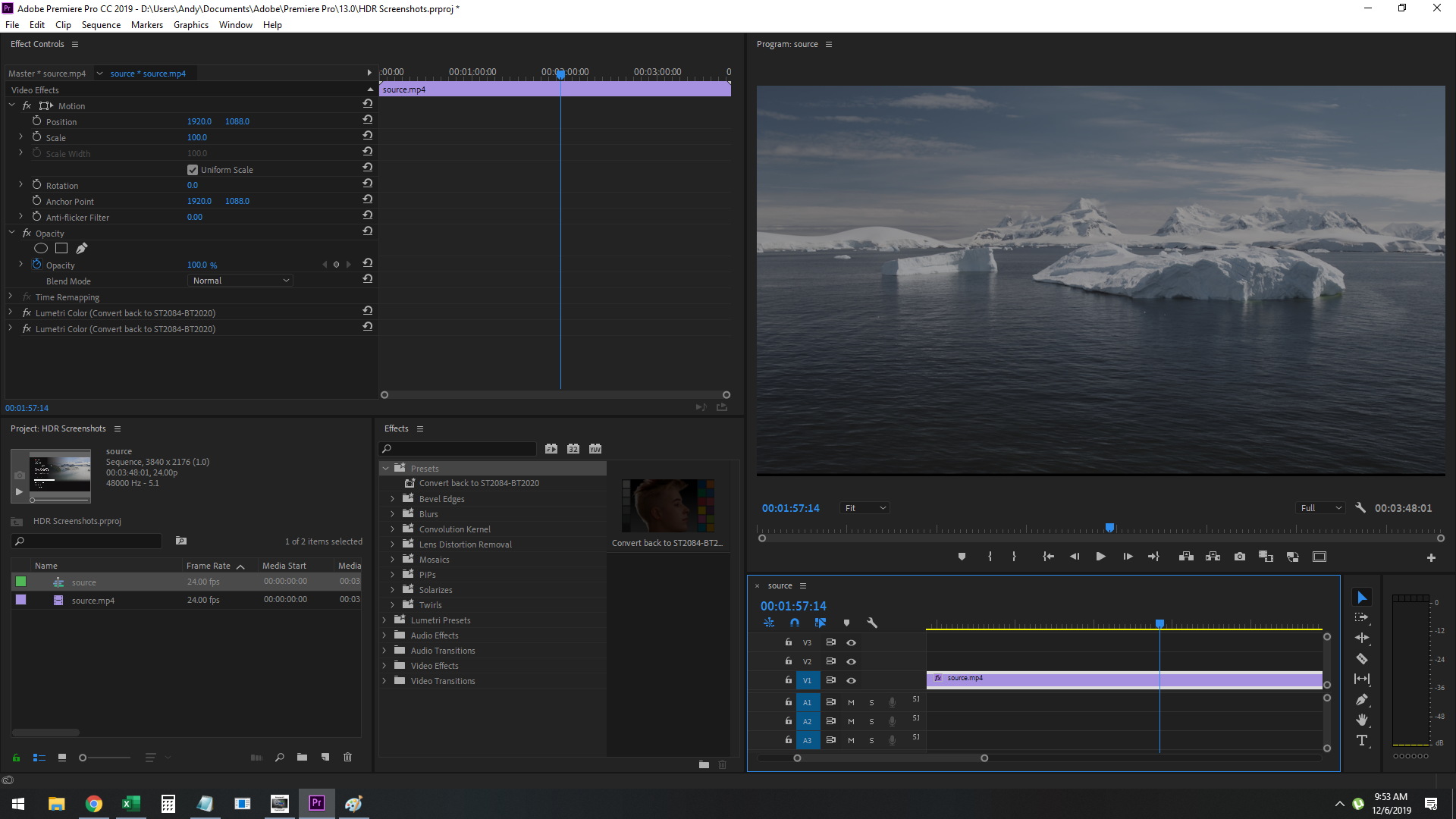

    On playback on 4K TV, the TV does not recognize it as HDR. Also, the whites are now "zebra-ed" on the TV which is a really weird effect. (You will almost certainly not "see" this unless you attempt to playback on HDR 4K TV.) Playback on an SDR monitor looks normal. Please note Voukoder gave me no choice but to choose bt709 colorspace as bt2020 is now gone as an option with update.
    What I think we have here is just really a lot of problems with Voukoder and HDR and BT2020.
  • You will need the latest 2.3 build, and follow the instructions in my guide here:
    HDR Encoding Guide for Premiere Pro
    The problem is with the way Premiere deals with HDR video. What voukoder gets is what's displayed in the program monitor. What it's expecting is the raw ST2084/bt2020 encoded video information, so you need to convert it to the appropriate format for voukoder to work properly. Don't use the colorspace filters as those will convert colors. Use the x265 flags as I outline in my guide instead.
    As I explained there, you will need to use x265 for now to follow this process. Some modifications may make NVENC possible but I'm not experienced with how NVENC handles HDR, so I can't help with that yet.

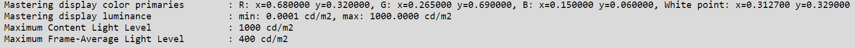

    Last time I tested the native HEVC output, it was indeed remapping and clipping. Perhaps that's changed since CC2018, but I would wager not if the output is described as full range. You could test with some "black clip" hdr test patterns. If it is remapping, it's possible your TV can understand full range HDR files, even though they're completely against the HDR10 spec.
    There does seem to be some metadata there. I'm going to take a guess that premiere is either copying directly from the source file (which results in inaccurate metadata if there are edits) or it's just spitting out a default number. If it's copying from your source, it sounds like your source is using some default combination, meaning it's not actually accurately representing the content, because no properly mastered content would actually have metadata numbers that even.
    Also, best not to use "16-235" when describing HDR, because it's technically 64-940. Limited or legal range is fine.
    Ultimately, if it works for your purposes, that's fine. For me, it's absolutely not acceptable. I would have no way to monitor my edits in HDR, no way to monitor any color grading I might do, wouldn't be able to have a consistent quality between encodes, etc.
    EDIT: Confirmed the metadata is not accurate, I quickly saw frames that had CLL above 1800 nits.
