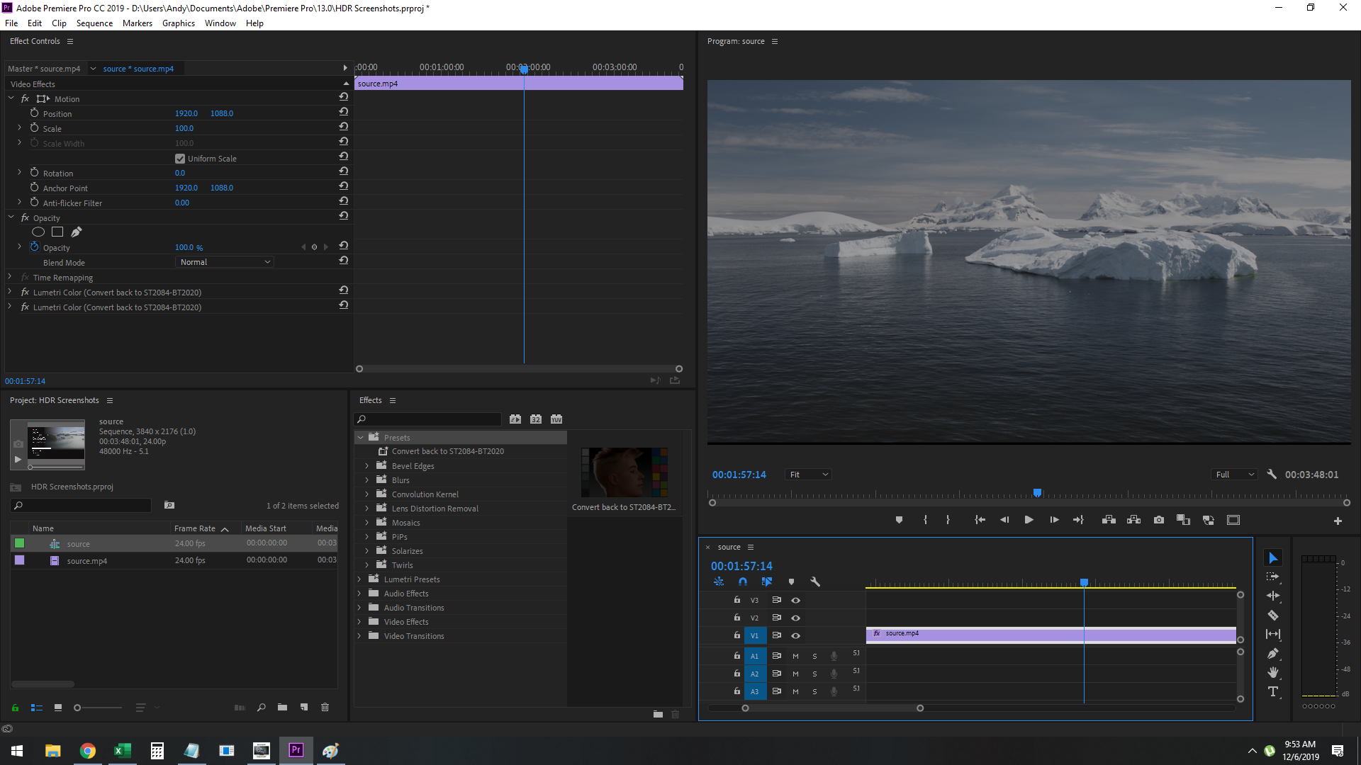

    Re: HDR encoding guide, here is monitor with the Lumetri presets you provide:
    https://i.imgur.com/ZjRO5fV.jpg
    And here is what it is "supposed" to roughly look like:
    https://i.imgur.com/QPMnHsA.jpg
    And here is output file sample using BT2020/SMPTE2084/BT2020NC:
    (the link is coming! will update in a minute....)
    Using your guide, the output is ULTRA-dark, almost unwatchable; this is what we might guess it would be just from the monitor view in Premiere. For me for whatever reason your HDR encoding guide is the worst I have seen so far in terms of outputs. Try it on the source file I originally linked to.

  • The monitor SHOULD look dark/incorrect. It's pre-processing the output in SMPTE2084/BT2020, which your monitor is not displaying in. If you displayed it on an HDR monitor, in HDR mode, it would look correct. Since your TV is not displaying it correctly, what are you watching it with? It's very likely your player is not processing the HDR signal, an is therefore just showing you an image similar to the premiere monitor window. What does it look like if you re-import it back into premiere without my preset applied?
    I'll test your video and see what I get.
  • I just realized something from your screenshot. Are you using Premiere 2020? I created and tested my preset in 2019, and that's what I'm still using for now. It's possible 2020 is handling HDR input differently than 2019 did. For example, 2019 doesn't map black levels correctly on HDR inputs, as it expected a full range video and got limited range instead, and so my preset had to correct for that as well. So if 2020 is handling HDR input differently, I'd need to create a different preset for 2020. If you happen to have a copy of 2019 still, I'd see if it's working there.
    yes I am using Premiere 2020, the latest version, just upgraded a couple weeks ago. Re: the "other" Lumetri you saw which I had added, it was empty/doing nothing. Only your two were active.
    Your monitor is def showing the footage w/Lumetri correction a lot brighter/visible than mine (I understand it prob would look darker; mine is just REALLY dark w/your correction). Maybe the difference is Premiere 2020??? If so... I'm worn out! I don't wanna change and downgrade lol. And as mentioned, for whatever reason, it's essentially impossible (I am too dumb) for me to get Voukoder v2.3 to give me an output my HDR TV recognizes as HDR right now.

  • I just tested in 2020 and my preset still works correctly. Not sure what's going on with your end. Try redownloading the preset as I do see the preset is named differently in your screenshots and mine. Perhaps you grabbed an older version of it before I reuploaded. I don't remember exactly what I changed before I reuploaded, but I did change something.
    Nevermind, found the issue
    2 Mal editiert, zuletzt von morphinapg (6. Dezember 2019 um 22:00)
  • Never mind the previous post. I found the issue and created a new preset for Premiere 2020. Use this and then try encoding to HDR.
    Remember, the output window will look desaturated and darker, but that's because it is transformed into a format that your display is not set up to preview correctly. It should however be in the correct format for 2020/2084 output.
