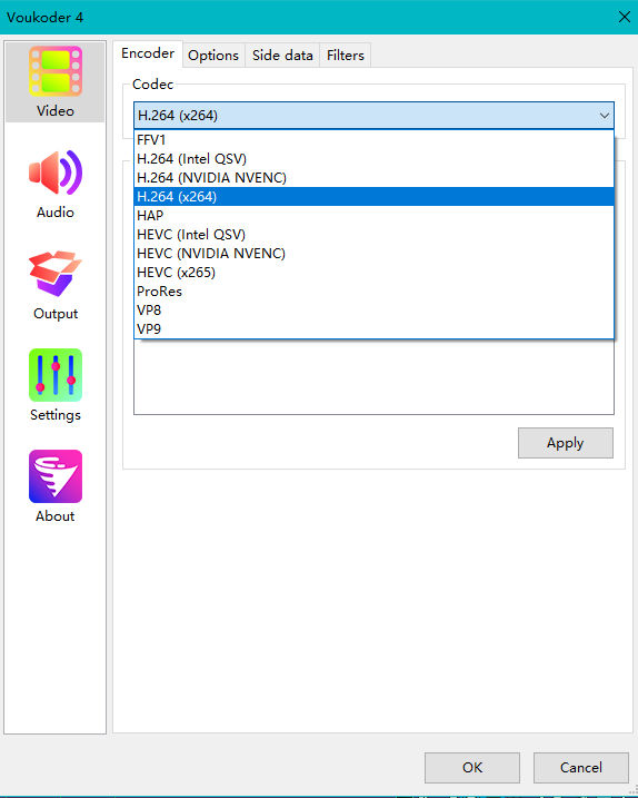

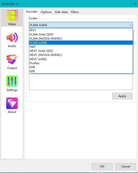

Hello Sorry, I have thought that the 4rc1's GIF problem is already fixed in 4 formal version. Unexpectedly it is still exist in 4 formal version. I mistakenly thought only me have this problem.
Lan-Na No, i need to Improve the connector to be able to select gif. It does not depend on a voukoder release.
