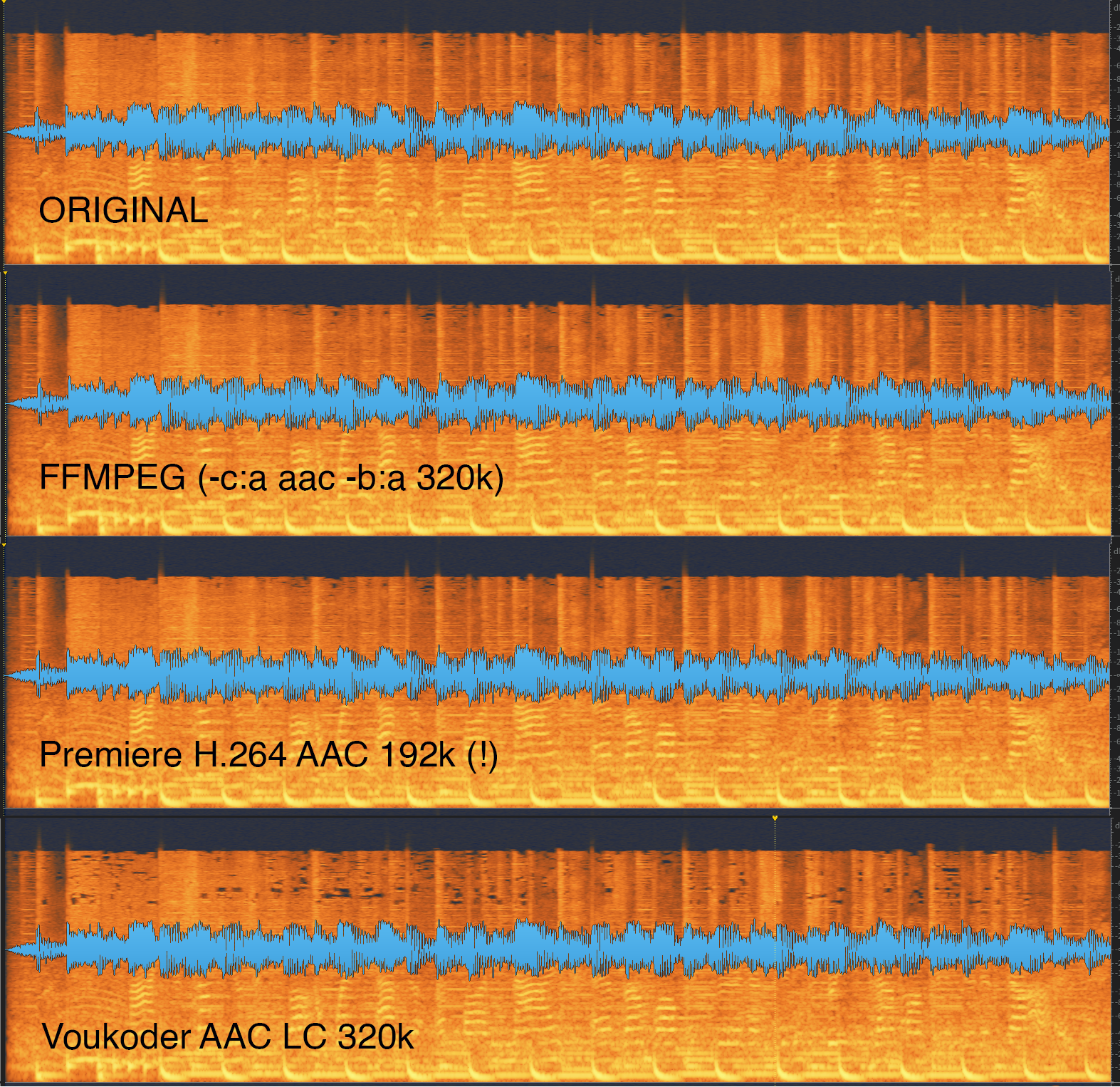

I am facing issues with the AAC output of Voukoder. The sound quality is bad with audible artifacts even at 320k. In comparison with AAC encoded using FFMPEG or Adobe H.264 AAC codec the artifacts are clearly visible in the spectogram. Even 192k on the other encoders sounds much better than 320k with Voukoder. Any solution for this?

Export as uncompressed PCM as well as MP3 is flawless.
You have to download the fdk-aac dll file and put it in the system32 folder of windows az5456 .
- So the audio data (float32) from premiere is pretty much okay.
- float32 -> s16le (pcm) is okay too
- float32 will be directly send to the aac encoder as "fltp" (no conversion)
- it has to do with the aac encoder
Maybe it has to do with the options?
