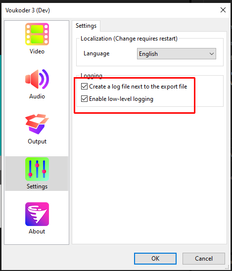

  • Well, it's probably too late to write logs.
    at the moment, everything continues to work as it should.
    I turned on for the future.
    also i’ll use neat video after, maybe I’ll catch a conflict.
    but I can’t find where this "deep log" is?
    it seems to be nowhere, Debug Database.txt is it it? or not
