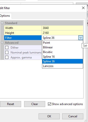

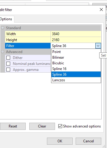

    And another question, what the better ZscaleFilter? Which will give better UpScale result?

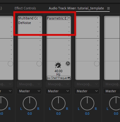

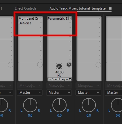

  • Very strange, but in the recent project I had 35 fps =( GPU using 30%... The drivers the same.. But in this project I used a few audio filters. could it affect the speed?
    Video duration - 18 mins
    Here is a log file.
    2020-09-11.zip
    I will try to install the latest Voukoder 6.2 and try to delete this filters. And let you know and will send another log.
    PS. In the previous 3 minute test - I used the same filters..

    I don't think it's the audio filters. To me it seems your system is sometimes too busy / stalling.

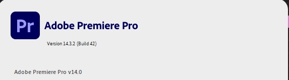

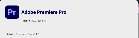

  • This is my Premiere Build.
    Tried to cut this project to 5 minutes, deleted all audio, text, sub-sequences and left only one layer with one video without cuts and etc.. and tested again on the latest Voukoder 6.2.
    FPS - 112
    GPU used - 70-100%
    LOG:
    2020-09-11.zip
    So, what do you think, what's wrong with my main project? And how to fix bad FPS.
    Thank you and have a great day
    Best regards,
    Andrew.
    Well, this is not a voukoder bug or issue, but ... Ok. ;) I don't see any correlation between the spikes and the projects timeline. The project itself is rather simple and uses not many effects and special transitions. I guess it is either premiere or the system itself.

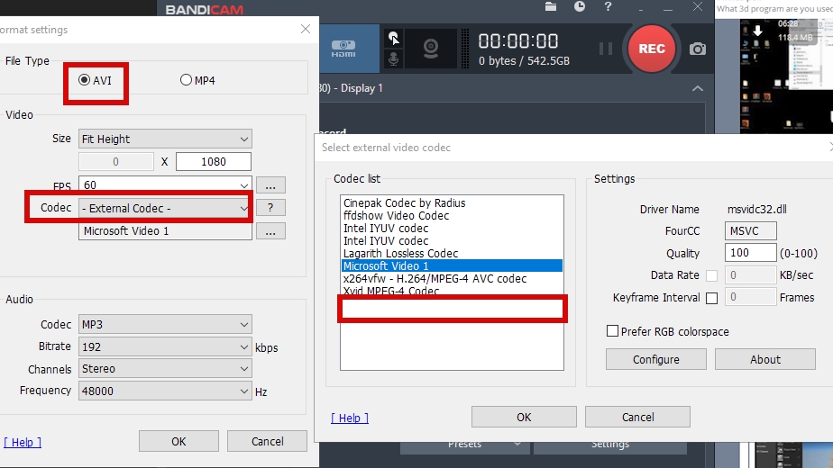

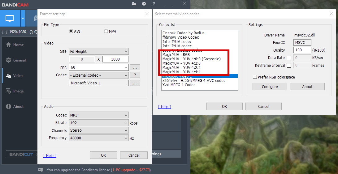

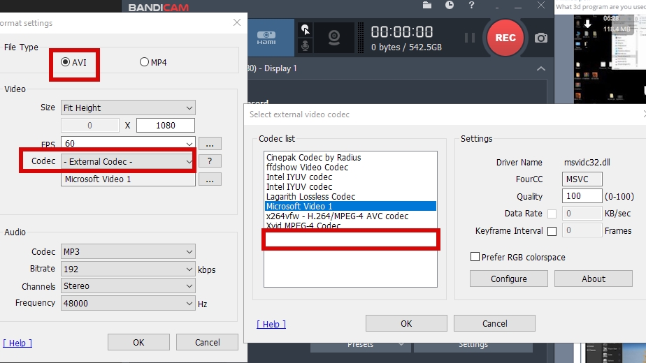

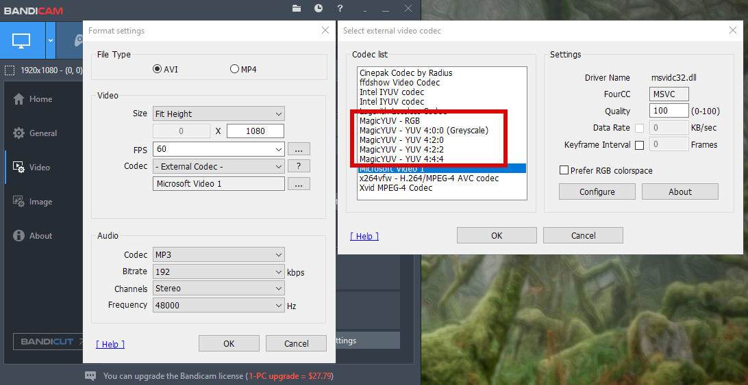

    I noticed you are using Bandicam for recording your screen to mp4 (NVENC). I did the same for game recording a loooong while ago (I love bandicam for screen recording). Did you ever try to record to AVI using the MagicYUV codec? It is designed to be mathematically lossless and extreme fast encoding and decoding. I loved working with that. Would be interesting to see if there is any difference. H264 was not designed to be an intermediate codec.
  • Well, this is not a voukoder bug or issue, but ... Ok. ;) I don't see any correlation between the spikes and the projects timeline. The project itself is rather simple and uses not many effects and special transitions. I guess it is either premiere or the system itself.
    So, as I understand, I should download MagicYUV codec, then selected "AVI" and it in External codecs? Right?

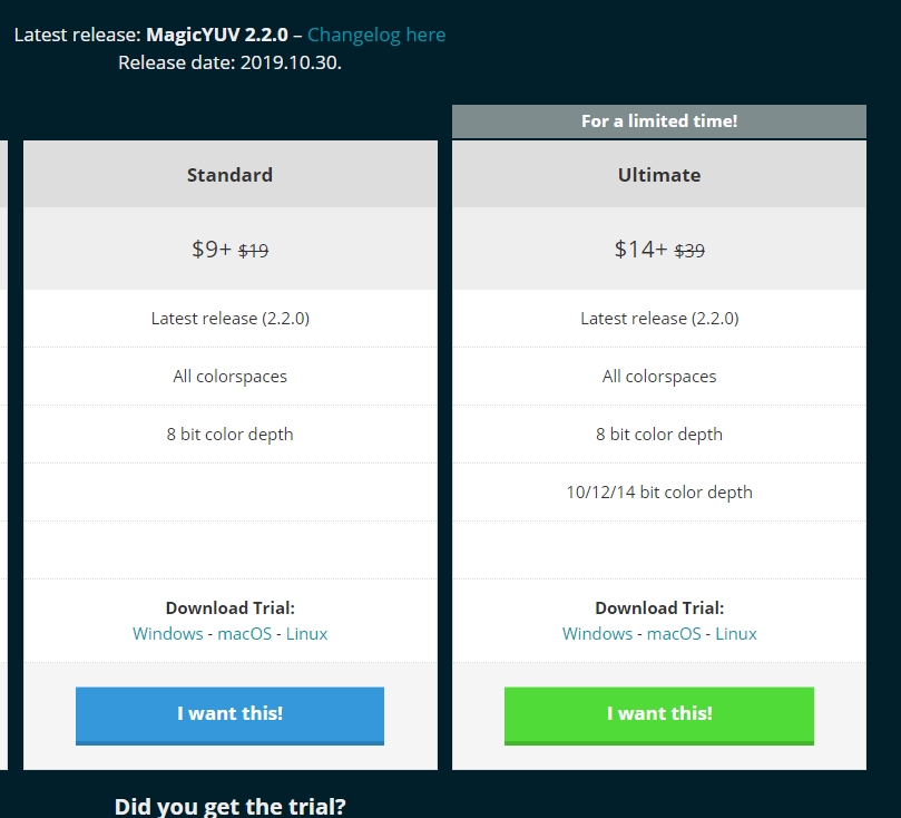

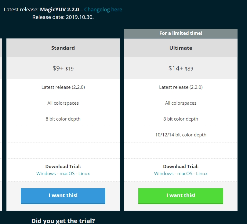

    Ok. I will try this, but firstly I should understand one thing. Which version I should buy =)
