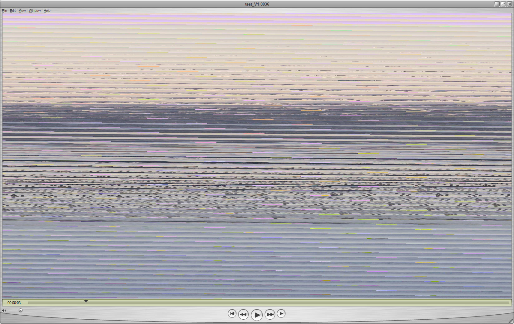

  • I have a project which can't be rendered. I tried everything, updated render settings, restarted the PC, updated the connector to the latest beta 5, with the same result.
    The screenshot and the log are attached, the link to the video is: https://drive.google.com/file/d/1qkXoeh…iew?usp=sharing
    The project itself is not "regular": it has been processed with DaVinci's media management without relinking, and clips have been relinked manually. But inside the project, everything looks fine, clips are playing correctly, and the rendering going visually normal. But the result is unusable.
    Delivering as individual clips, ProRes 422 HQ, "high bit depth" setting in DaVinci.

  • some additional info.
    It happened with size mismatched between source clip, timeline, and delivery.
    The source clips were smaller but stalled to meet timeline size, and render was set to "source resolution".
    I was able to reproduce this. To me it seems the frame buffer does not have the final video stream resolution. But I am not able to get some information (stride) about the image in the frame buffer. I always get "noParam(-6)" ... More hassle with undocumented code ...
