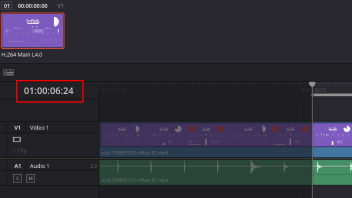

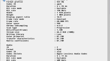

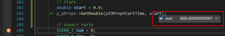

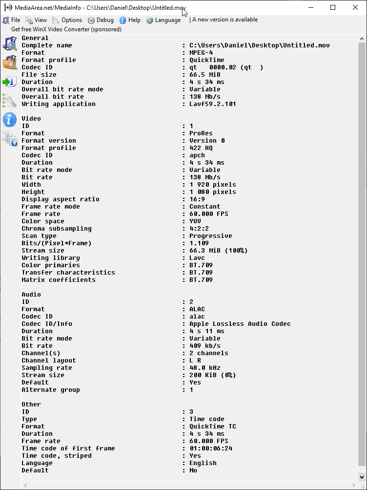

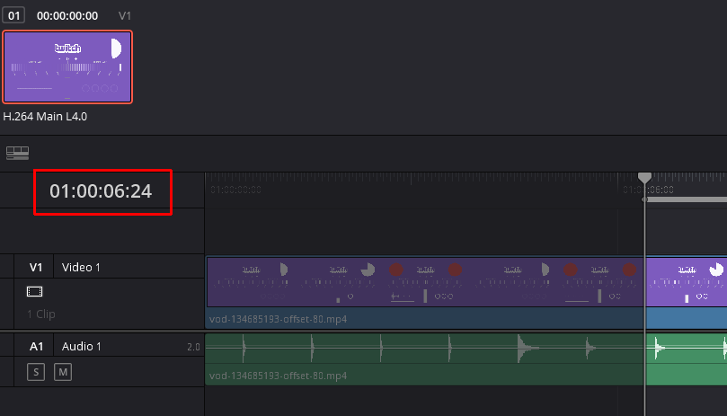

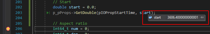

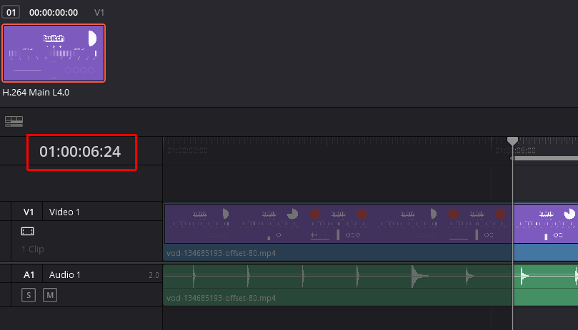

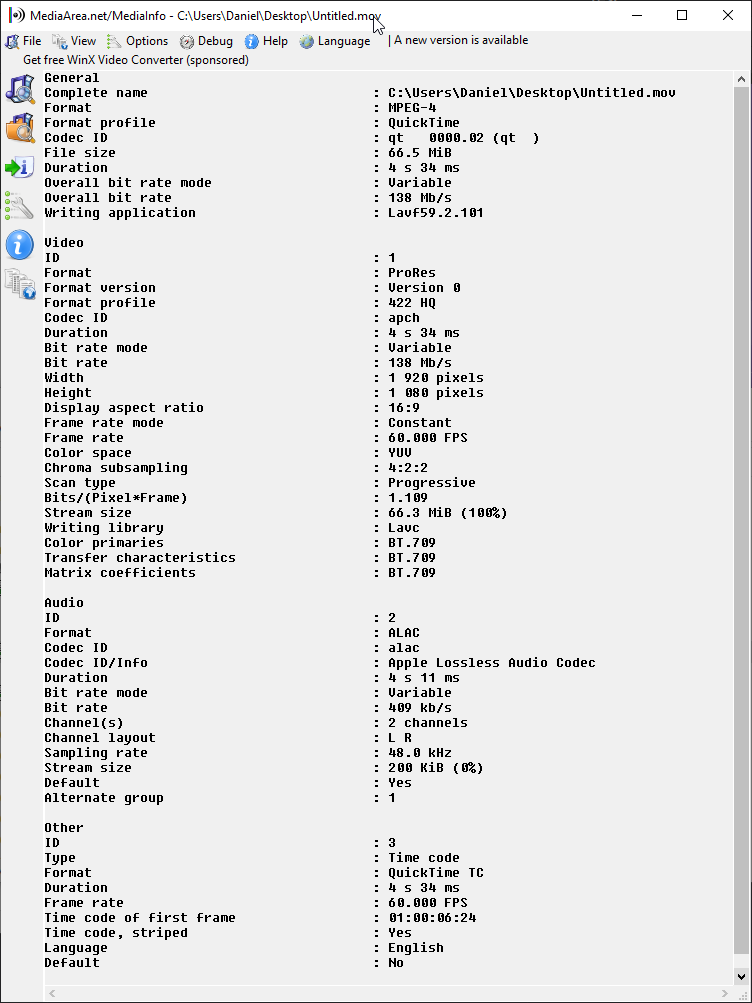

This is how i tested it:
3600/3600 = 1 hour
0/60 = 0 min
6/1 = 6 s
(0.4 * 60) / 1 = 24 // timebase is 1/60 ~ 60 fps
results in 01:00:06:24 (So this is the timeline timecode, i guess)
