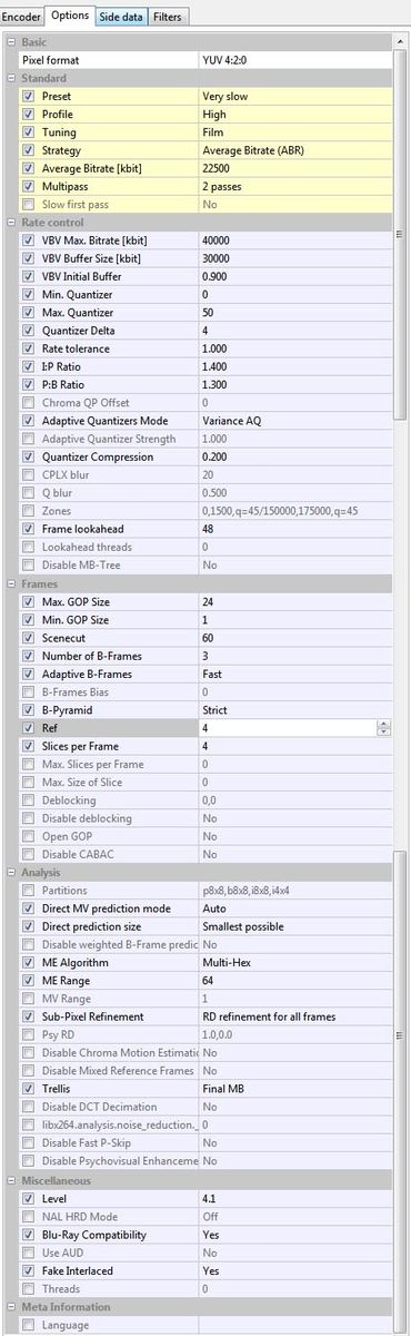

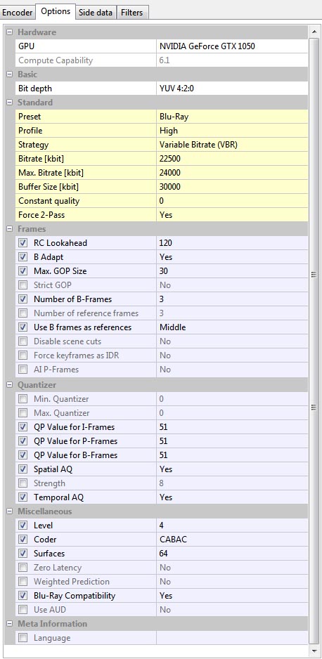

  • Are you using NVENC or x264 for encoding? I can give you example settings for both. Are you trying to import 720p or 1080p? Frame rate?
    Note that the TMPGEnc "RE" marker will appear for all files that it can't use directly. You can left mouse click on the RE and an info box will come up to show what video stream parameters are not compatible, then adjust the Voukoder setting accordingly. Most common is to ensure you're at level 4.0 ML/HP.

  • In the Preset dropdown, I don't have a Bluray option. Just 7 speed options from Slowest to Fastest. Tried rendering using the other NVENC settings as shown, and Architect Pro doesn't even recognize the resulting file as a valid video file . . . although it'll read the audio track.

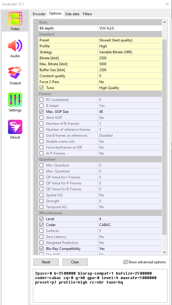

  • I don't understand. Just switch over to the Options tab, ignore the Presets, and select as indicated. If BluRay option isn't set in options, won't work. Only way that "Slice" gets set correctly for NVENC.

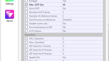

    You don't need all of @avwtp's bells and whistles above to get Blu-ray compatibility. The main things are:
    • h.264 format
    • Blu-ray Compatibility enabled
    • Max GOP size (aka, "keyframe interval"): max 48 (for 23.976/24p video), or max 60 (for 29.97/30p video)
    • CABAC encoding
    • Level 4.0 (technically, 4.1 is allowed by the Blu-ray spec, but I find TAW won't accept Level 4.1 video)
    • resolution/framerate within Blu-ray specs (see the Wikipedia page https://en.wikipedia.org/wiki/Blu-ray)
    • YUV420P color format
    • B frames as references disabled
    Other than the settings listed above, the rest is just playing with encoder settings to get your desired picture quality or render speed. You should be able to leave everything else at default and still get TAW-compatible renders. If you screw anything up, TAW will usually tell you what you did wrong.
    The attached photo is a very barebones configuration that should be TMPGEnc / Blu-ray compatible. (UPDATE: also need to disable option "Use B frames as references". See note below.) The bitrate is really low, so you'll probably want to raise that (this project involved putting 19 hrs of video onto a single disc).
    UPDATE (Aug 2024): When using newer versions of FFmpeg, the option to "use B frames as reference" also needs to be manually disabled for Blu-ray compatible renders. Otherwise, TAW will insist on re-encoding the file, even though it won't report any issues with compatibility. (In older versions of FFmpeg, this option was off by default. In newer versions, this option is enabled by default.)
    23 Mal editiert, zuletzt von Joe24 (10. August 2024 um 06:41)

  • I couldn't find a setting for CABAC
    Then I'm guessing your particular GPU only does CABAC encoding.
    Just did a test because I was curious, and it seems that TAW will also accept CAVLC encoding.
    What was probably messing you up last time is the Group-of-Pictures max size (GOP). Most encoders have a really large value by default, mine is 300. For Blu-ray though, this number has to be manually limited to 48 or less (for 24p video).
    Just to clarify, feel free to experiment with the other settings, as you can tweak your picture quality and encode speed quite a bit. @avwtp's settings will probably give you a much better picture than mine. But the settings that are absolutely critical to Blu-ray compatibility are listed in my last post.
    Einmal editiert, zuletzt von Joe24 (15. Januar 2023 um 01:46)

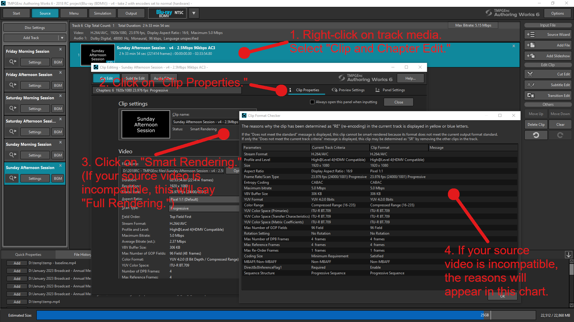

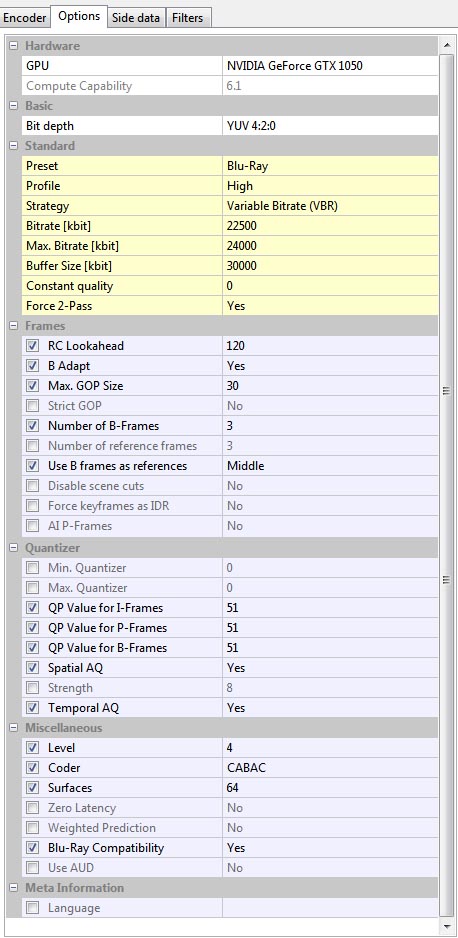

  • Here's how to check in TAW6 whether your source file is compatible or not :
    Note that TAW6 uses fields, not frames, to indicate it's max GOP size. Voukoder "48 frames" = TAW6 "96 fields".
