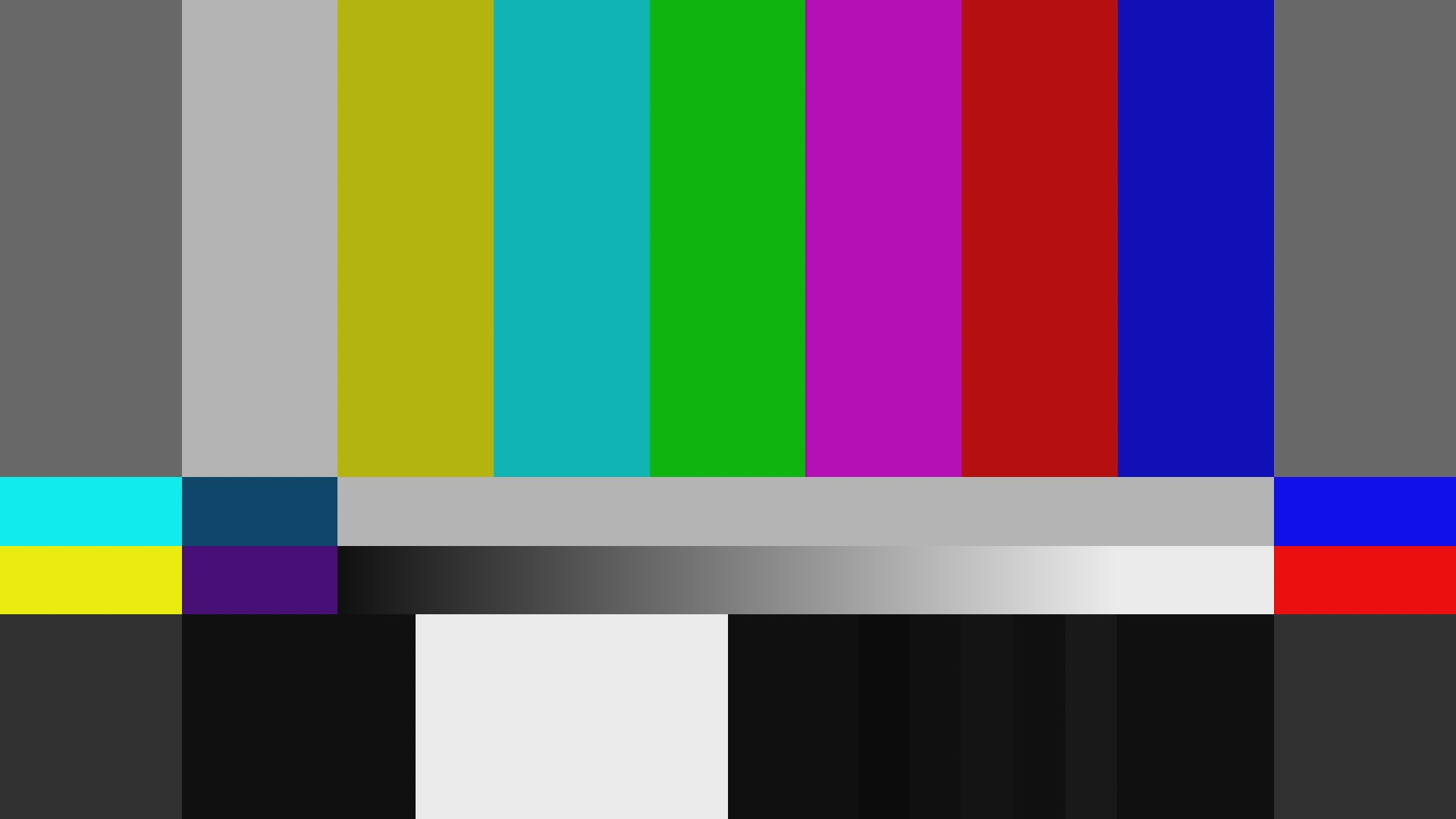

    • I created an SMTPE bars MXF clip with premiere:
    • Renderer this with DVR / Voukoder to ProRes 422HQ:
    Input #0, mov,mp4,m4a,3gp,3g2,mj2, from '..\..\..\Desktop\smtpehd.mov':

      Stream #0:0: Video: prores (HQ) (apch / 0x68637061), yuv422p10le(tv, bt709, progressive), 1920x1080, 21562 kb/s, SAR 1:1 DAR 16:9, 25 fps, 25 tbr, 12800 tbn, 12800 tbc (default)

  • The main problem is the prores mov rendered with Voukoder is misinterpreted by NLE software (Resolve in my case). For some mysterious reason "Full Range" is taken for "Limited Range"/"Video", which results in "cut" low blacks.
    But even if you set the interpretation mode correctly, something bad happens with the low end blacks. They are "squashed"...
    Einmal editiert, zuletzt von Edixth (17. Oktober 2021 um 15:40)
  • ProRes by its spec should be always limited range. There is no flag in its private stream nor in MOV headers which specifies video range.
    You can create full range ProRes, but then you have to ALWAYS manually interpret such a files as full range as not a single app will know it's full range. Some apps (like Premiere) assume by default that full range is used for ProRes444, but there is no rule to it. Resolve itself still loads all ProRes files as limited range which is how it should be.
