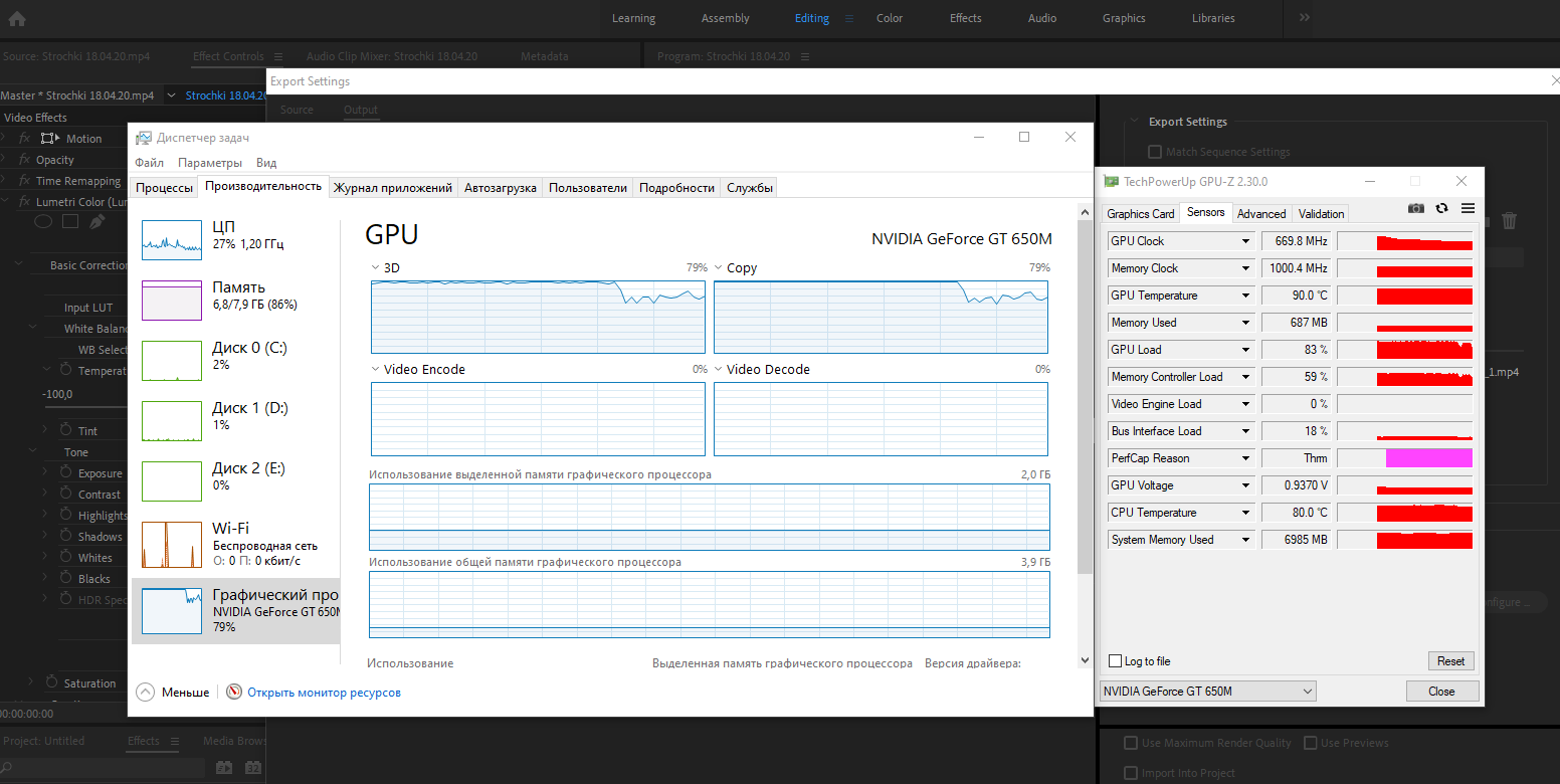

    I'm sorry, Vouk, not yet... Yesterday I rendered one ordinary video and everything was fine with it (speaking of NVENC). Today I tried to render a bigger timelapse video and I was not capable to do it... Reverted to x264 method.
    After this combination I got this result, see attach... My laptop is old Dell 7270 Core i7, videocard Nvidia GTX-650 with latest driver, Window 10 after clean installation.
