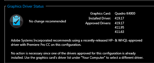

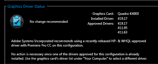

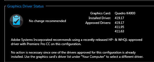

    Although my latest driver is newer than this one I see some complications.
    If you could explain more on this decision and on how could this hold you back on development.
    I understand many of them as I have written code on my own in the past.
    Will this be only for nvenc encoding or ?
    As is shown here my previous drivers were 411.63 if I remember correctly and I think that I have some issues with the latest drivers.
    I'm not sure 100%, but this could leave me or some users out of options.
