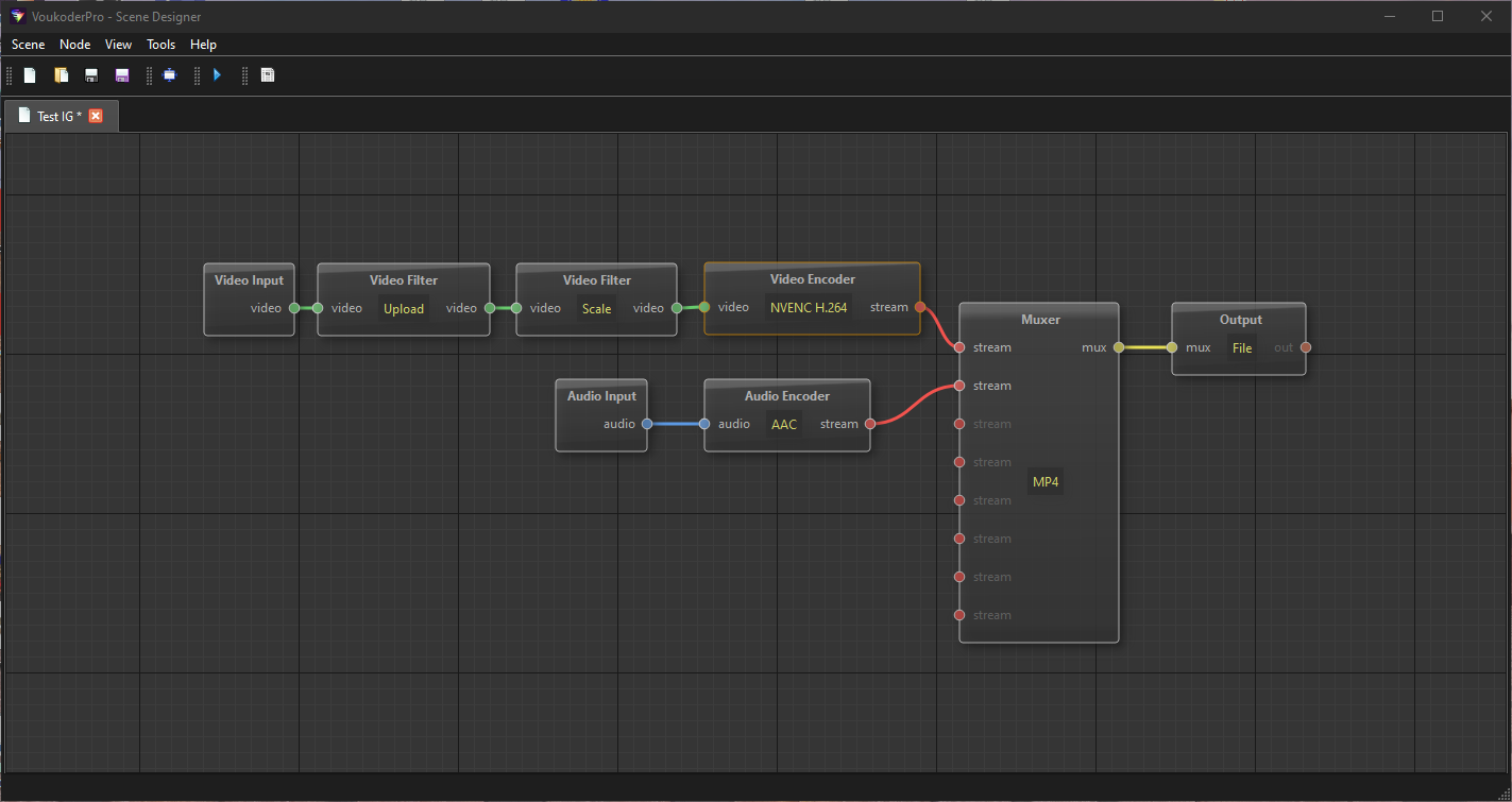

    Can you export and send me that scene file?
    well as I don't know how things work in VoukoderPro my config might be the problem, but here you go.
    I was not able to upload it so here is what's in the file:
    "name": "Test IG",
    "nodes": [
    "id": "64425d20-dc55-42fa-944c-d981eb072d3d",
    "type": "input",
    "mediaType": "video",
    "pos": {
    "x": -50.0,
    "y": -78.0
    "data": {
    "selection": "all",
    "color": {
    "range": "tv",
    "matrix": "auto",
    "primaries": "auto",
    "transfer": "auto"
    "inputs": [],
    "outputs": [
    "17c1eafa-af18-41d7-ae6f-c6d0c8f02859"
    "id": "4b9e0709-12eb-4b8b-8a9a-45c9b6121e4f",
    "type": "input",
    "mediaType": "audio",
    "pos": {
    "x": -50.0,
    "y": 32.0
    "data": {
    "selection": "all",
    "color": {
    "range": "auto",
    "matrix": "",
    "primaries": "",
    "transfer": ""
    "inputs": [],
    "outputs": [
    "7e75946c-42f1-4381-8c8d-b979edcb2da3"
    "id": "72bcf162-3d54-410f-8923-63eee5443750",
    "type": "encoder",
    "pos": {
    "x": 90.0,
    "y": -78.0
    "data": {
    "id": "h264_nvenc",
    "params": {
    "preset": "p7",
    "profile": "high",
    "rc": "cbr",
    "b": 100000000,
    "bufsize": 100000000,
    "tune": "hq",
    "bf": 0
    "format": "cuda"
    "inputs": [
    "outputs": [
    "cca33751-0a9f-4b84-ba88-893bbef611df"
    "id": "eb0f10ec-6af2-4fe9-aff2-1889879b2591",
    "type": "encoder",
    "pos": {
    "x": 90.0,
    "y": 32.0
    "data": {
    "id": "aac",
    "params": {
    "rc": "cbr",
    "b": 128000,
    "global_quality": 1,
    "profile": "aac_low"
    "format": "fltp"
    "inputs": [
    "outputs": [
    "e85852c9-ac72-47b7-ae15-c1ef19ffac35"
    "id": "1aff3d7d-835b-41ea-b064-3f8499434cb5",
    "type": "muxer",
    "mediaType": "mux",
    "pos": {
    "x": 330.0,
    "y": -40.0
    "data": {
    "id": "mp4",
    "params": {}
    "inputs": [
    "outputs": [
    "26765a57-4b3e-4375-86fc-b2692412e4e9"
    "id": "500b1eac-7a57-47aa-89ab-b10cd0d985be",
    "type": "output",
    "mediaType": "mux",
    "pos": {
    "x": 530.0,
    "y": -40.0
    "data": {
    "id": "file",
    "url": "$(OutputFilename)",
    "params": {}
    "inputs": [
    "outputs": []
    voukoderpro-0.log letzte Zeilen
    2023-08-25 05:57:18 (trace) [FFmpeg:0] auto-inserting filter 'auto_scale_0' between the filter 'buffer@64425d20dc5542fa944cd981eb072d3d' and the filter 'Parsed_format_1'
    2023-08-25 05:57:18 (trace) [FFmpeg:0] Impossible to convert between the formats supported by the filter 'buffer@64425d20dc5542fa944cd981eb072d3d' and the filter 'auto_scale_0'
    2023-08-25 05:57:18 (error) [InputNode.cpp:110] Unable to configure filter graph.
    2023-08-25 05:57:18 (error) [Router.cpp:202] Init phase of track #0 (video) failed!
    2023-08-25 05:57:18 (error) [Router.cpp:242] Initialization failed: -11
    2023-08-25 05:57:18 (info) [VoukoderPro.cpp:502] Unable to start VoukoderPro: FFmpeg error.
    Hey,
    so I just saw the VoukoderPro beta and figured I will give it a try. First, I noticed that i couldn't open the "Scene Designer" (in Vegas 20). So, I started the application (with admin perms otherwise it wouldn't open). I just tried to reconstruct my previous settings and wanted to see the result. As the title already says it gave me the following error: Unable to start VoukoderPro: FFmpeg error..
    I already installed ffmpeg on my pc and even added it to path, so I don't know how to fix this error, anyone of you have an idea?
    Regards,
    2sa
