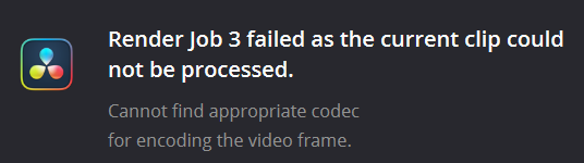

    I'm trying to render a video with the simple "H.264" preset. Whenever I try to begin the render, I get the following error:
    "Render Job 1 failed as the current clip could not be processed. Cannot find appropriate codec for encoding the video frame."
    Looking in the logs, I found this:
    [21:42:03] Loading: encoders/h264_amf.json
    [21:42:03] FFmpeg: DLL amfrt64.dll failed to open
    I have an Intel CPU, but 'encoders/h264_amf' is for AMD processors. I believe this is because Voukoder is just calling "h264" and not specifying the type.
