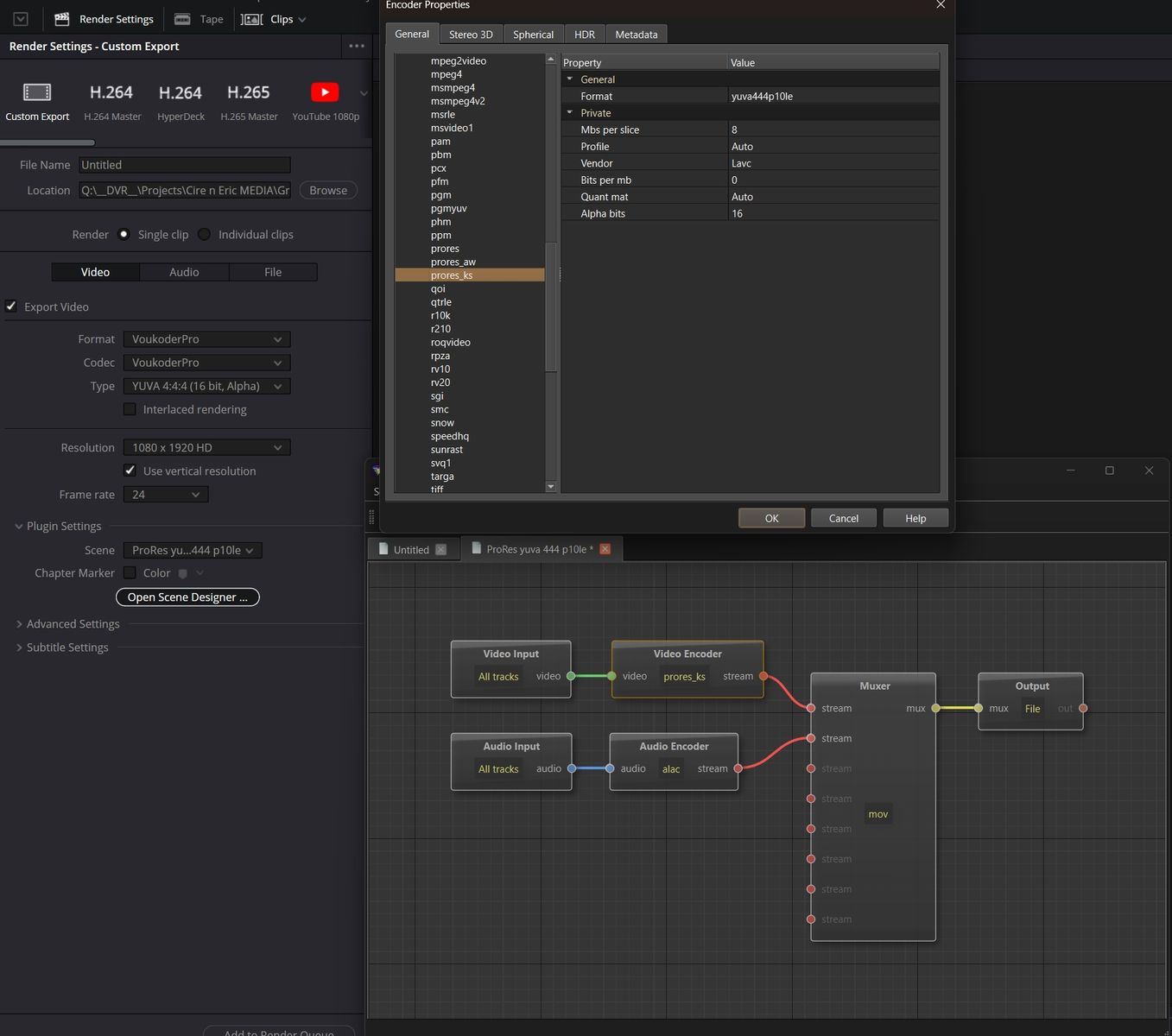

    Hi,
    << I too get no "export alpha" checkbox >>
    *attached the prores yuva 444 p10le profile.
    ** hope it's ok, I think this may be related, though I think you're right (the internal was there for the old one, but mine as you can see it "VoukoderPro" for both Format and Codec.
    THANKS for this add-on!!

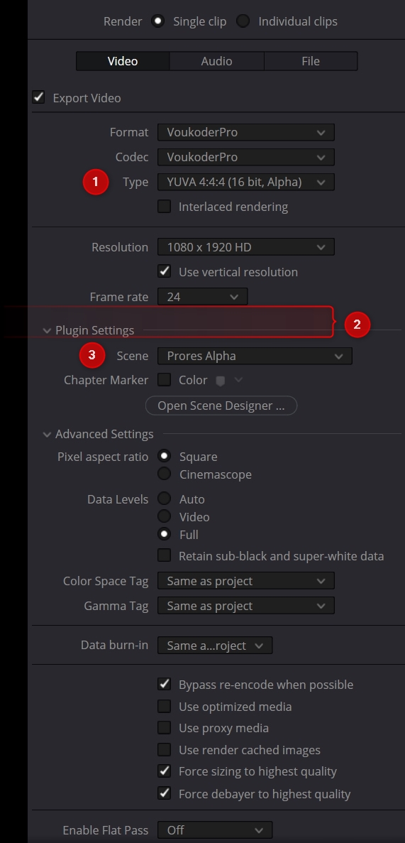

    Notice when YUVA 444 (16 bit, Alpha) selected in Type still no checkbox for Export Alpha. yes it's there for DNxHQ w/alpha, or PNG etc.

    I started from the default video encoder ProRes KS, changed to yuva 444l10e, changed the format to 4444, and left the rest alone.
    muxer defaults to mov, so I left that alone.
    exports simply are missing the alpha (and are 75% of the size too ;) )
    See below:
    1) selected first
    2) 2 expected the export alpha - ok go to 3

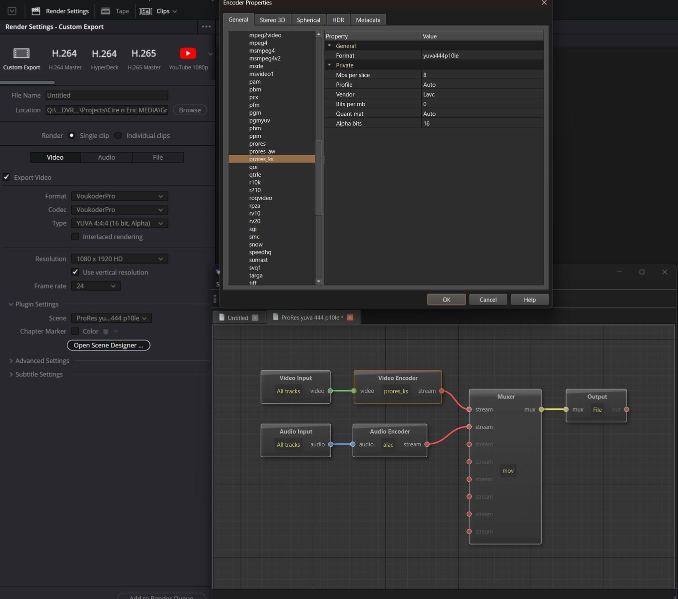

    3) open designer change video encoder to use yuva 444l10e (for settings see bottom image.) (I've re-created the Scene many times hence the discrepant name - but it's as attached )
    WINDOWS 11, Resolve 18.6, Voukoder 1.2.1
    here is the current "saved" profile.
